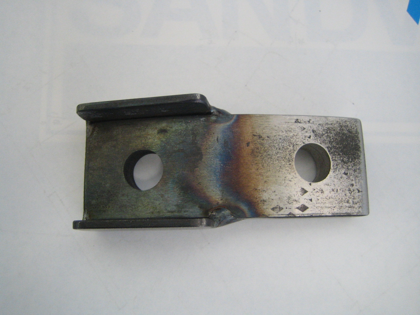

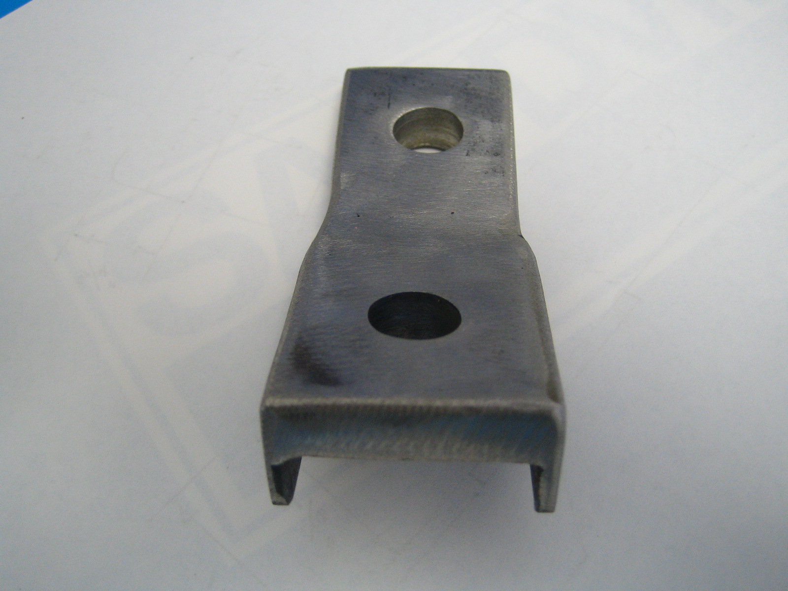

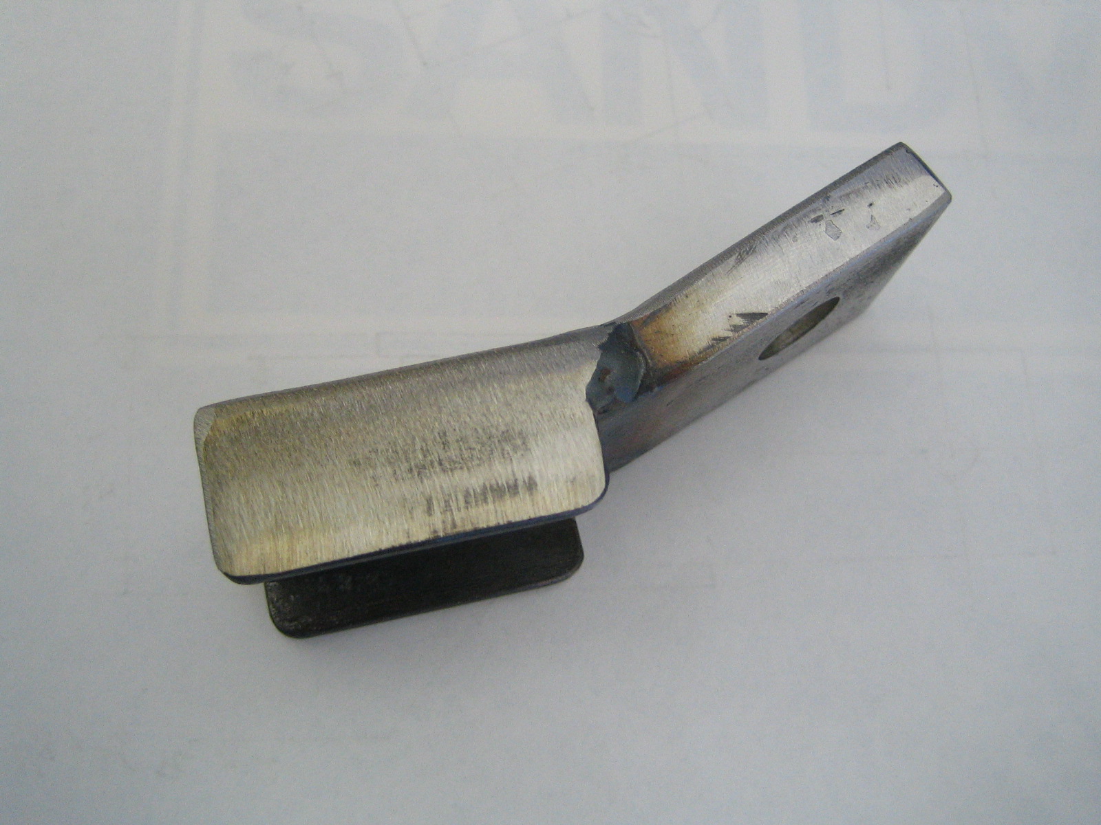

PostPosted: Sun Jan 18, 2009 10:39 pm    Post subject: Tail wheel Reply with quote
Well while you're contemplating your navel here some photos and details of the adaptor bracket:

gary.algate(at)sandvik.co
You are dead right - it really should be a castellated nut - good idea about the grease too
Gary - nice design, nice drawing, great photos and the craftsmanship is superb. You
obviously have access to tools. Maybe you packed them in with your plane in the big
trans-ocean crate.
How about a side elevation shot of with the tail wheel loaded? I suppose you have to
wait for the paint to dry. Smile)
regards
Gary
