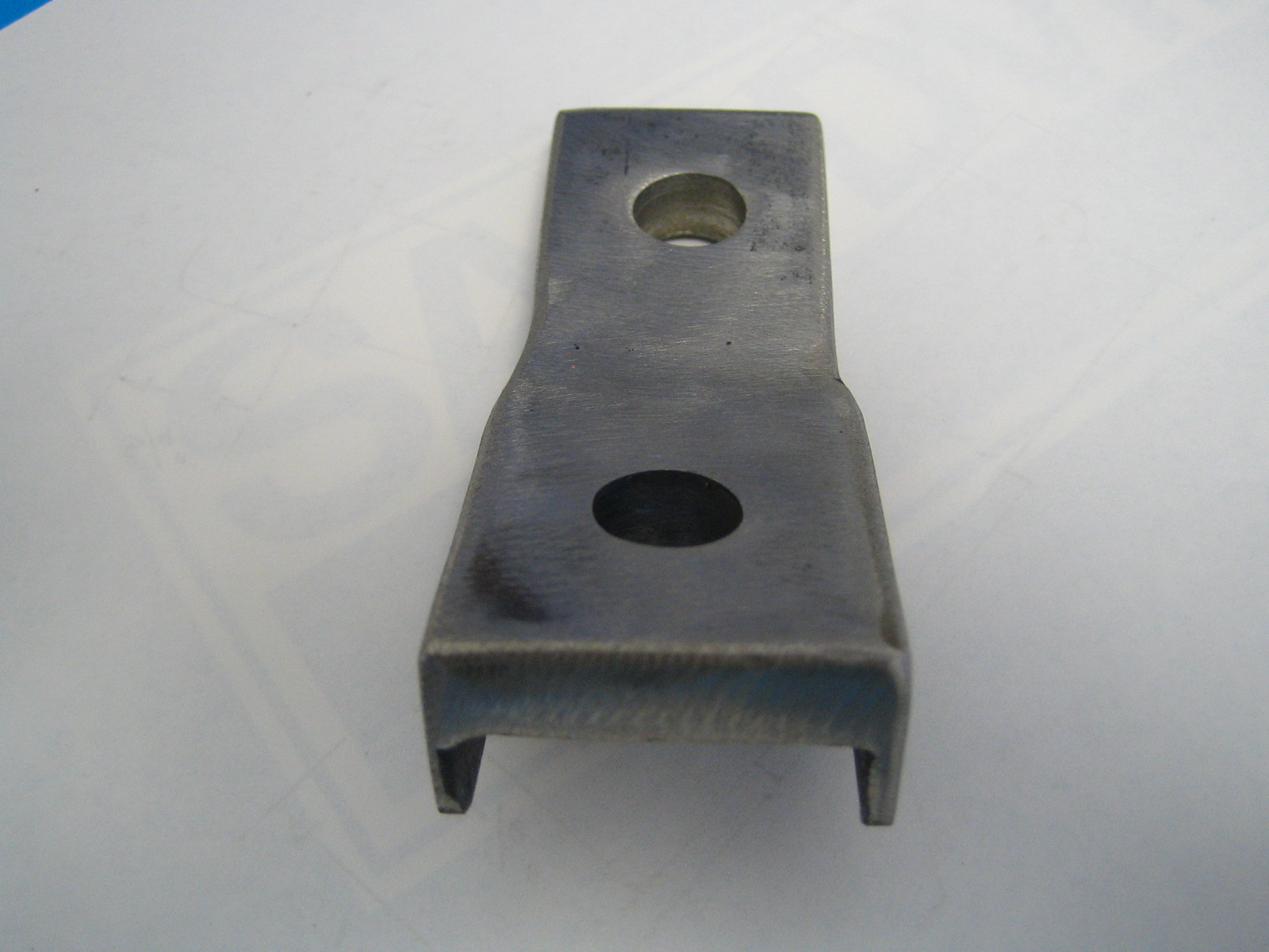

Well while you're contemplating your navel here some photos and details of the adaptor bracket:
regards
Gary

| Description: |
| Filesize: |
454.15 KB |
| Viewed: |
371 Time(s) |
| Description: |
| Filesize: |
372.16 KB |
| Viewed: |
377 Time(s) |
| Description: |
| Filesize: |
456.3 KB |
| Viewed: |
386 Time(s) |
| Description: |
 Download |
| Filename: |
img-1191544-0001.pdf |
| Filesize: |
9.44 KB |
| Downloaded: |
384 Time(s) |

On Sun, January 18, 2009 10:36 pm, gary.algate(at)sandvik.com wrote:
| Quote: | Well while you're contemplating your navel here some photos and details of
Gary - nice design, nice drawing, great photos and the craftsmanship is superb. You
obviously have access to tools. Maybe you packed them in with your plane in the big
trans-ocean crate.
How about a side elevation shot of with the tail wheel loaded? I suppose you have to
wait for the paint to dry. )

Great-looking, Gary....got it on yet?
Lynn Matteson
Jabiru 2200, #2062, 600.2 hrs
Sensenich 62x46
New skis done and flying
On Jan 19, 2009, at 1:36 AM, gary.algate(at)sandvik.com wrote:
| Quote: |
regards

gary.algate(at)sandvik.co Guest
Posted: Mon Jan 19, 2009 1:24 pm Post subject: Tail wheel |
Hopefully this afternoon I'll have it fitted and will post a photo - thanks Paul

--> Kitfox-List message posted by: "Paul Franz - Merlin GT" <paul(at)eucleides.com>
trans-ocean crate.

Posted: Mon Jan 19, 2009 1:48 pm Post subject: Tail wheel |
How about a spot for a drilled he4ad and a bit of lockwire?
Noel
