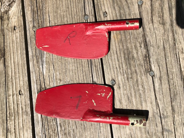

See the attached. I made these Spads better than ten years ago but never tired them. They fit in the fixture where the aileron balance weights go. Even drilled them to allow (I think) for the wing tip vortex.
Was going to try one on one side first so if it snatched or ripped something off the plane I might still have aileron control. Then I got concerned and never went any further.
Thoughts

You might have had a problem testing with one spade.
If I decided to take on that task I'd do it with two.
Seems to me the spades need to balanced.  One spade would be severely out of balance, nothing to counteract the single spade except stick force.  Might be a hand full.

Gents,
I have mostly been enjoying other people's posts and staying quiet but decided there was enough safety issue here to comment.  I was an F-106 and A-10 driver years ago and went on to a career in NASA spacecraft design.  But my passion is aviation, and especially low and slow like Kolbs.  As part of that I built an original Firestar and later owned a Mark3X.  Loved them both but made a point to learn a lot about them too.
Spades obviously lighten stick forces by adding aerodynamic balancing.  They do this by digging in to the wind on the "other" side of the aileron hinge from what the pilot input is doing.  This helps you deflect the aileron.  And yes, Kolbs do have heavy ailerons, especially that M3X with flaperons.
But Kolbs are very unusual in a very important way.  The ailerons are heavy because they have lots of area with no aerodynamic balance.  If the aileron structure were rigid, they would feel even heavier.  That is because much of the movement you have in your stick comes from the aileron spar bending and twisting.  I used to be amazed that even with a bunch of stick input on the M3 the tip of the aileron hardly moved at all.  But what really got my attention was when I would stand at the wingtip and twist the aileron with the mass balance and see how easy it was to move it 3 or 4 inches after the stick had hit the stops.  This is not what I consider to be a safety issue because that big aileron is trying to stay streamlined and will not do anything funny (assuming you have mass balanced the faster ones), but it is unusual in aircraft design.
Now imagine that you have a spade out there on the end so that instead of the aileron spar bending against the predictable resistance of that big aileron there was a spade applying a booster force.  I assume that with small spades like in the picture installed symmetrically the handling would not change too much, but it might.  And if you did put just one on the aileron on that side would deflect much further both directions and could really mess with the handling.
I love Kolbs which is why I read this list all of the time.  And I would like all of you to enjoy them safely.

Jim what about spades mounted at mid aileron? It seems to me that the spade will reduce the amount of strain and deformation of the aileron system components.

Why don't you give it a shot and see what happens. I wouldn't mind lighter forces myself. You are in probably the best situation to try this. Larry

Why have spades at all?
Why have VGs?
Neither are a necessary mod.
I put VGs on my MKIII after I flew it 3400 hours for the past 34 years. Then I got an itch to give them a shot. I did not need them to comfortably fly my aircraft. It was a novelty to give them a try. Yep, they helped a little. I could fly a few mph slower, and best of all VGs did help clean up my full stall landings. At my age I was not as sharp as I once was, and found myself occasionally screwing up my landings.
I didn't need them but they did improve an already good handling airplane. I got mine from John Gilpin, STOL Speed VGs. You can also order them from Aircraft Spruce.
What started this thread was a very low time Kolb pilot and builder. I think he has less than an hour flight time already. This is the same guy that initially came on the List denigrating Kolb's elevator hinge system. Had to go get an aerodynamic engineer to tell thousands of us Kolb pilots and builders that we were doing it wrong, not the way the book dictated. So...we've flown thousands of hours without losing a single elevator, yet we are flying in an unsafe condition according to these experts.
Now...Bill Berle has flown his FS 20 minutes and he wants to redesign it because it does not fly the way he wants it to. Kolbs fly like Kolbs. That is one of the things that make them a unique aircraft, one that I have flown for many years. The reason I have stuck strictly to Kolbs is because I love them, the way they fly, the way they look, and best of all their superior crash worthiness. Maybe one of these days some of you all will be able to experience Kolb's crashworthiness first hand. I sincerely hope not.
I too complained to Homer Kolb many, many years ago about his heavy ailerons. I thought they should be light like a rotary wing cyclic, the aircraft I had some experience flying. Homer told me to be gentle with the Kolb and it would do just what you wanted it to do. Homer was absolutely correct. Imagine that. I've learned to use Homer's advice and have been privileged to fly in some pretty exciting places in some pretty exciting weather. I don't ever recall wishing I had spades to get me out of any situation. I didn't need them to get me home.
OK...something to think about when you're screwing with Kolb ailerons. Kolbs will not fly very long without aileron control. If you don't believe me, try to fly your Kolb with the ailerons locked, using rudder and elevator only. Those that put a bunch of dihedral in the wings can probably toot around all day flying without aileron input, but the plans built and rigged Kolbs won't. They'll maintain heading for a bit and then roll over and dive to the ground. Your rudder and elevators can't get you out of that situation. They will fly with one aileron. We've had folks lose aileron control on a single aileron.
If Bill B wants nice light aileron control and can come up with safe, workable spades, that is fine with me. I am not trying to encourage Bill to stop his experimentation. That's what it is all about, but I prefer to fly my MKIII just the way it is without them.
The above are my thoughts and opinions only. Not intended to influence anyone. I don't encourage anyone to do stuff the way I do it.
Good luck Bill B.

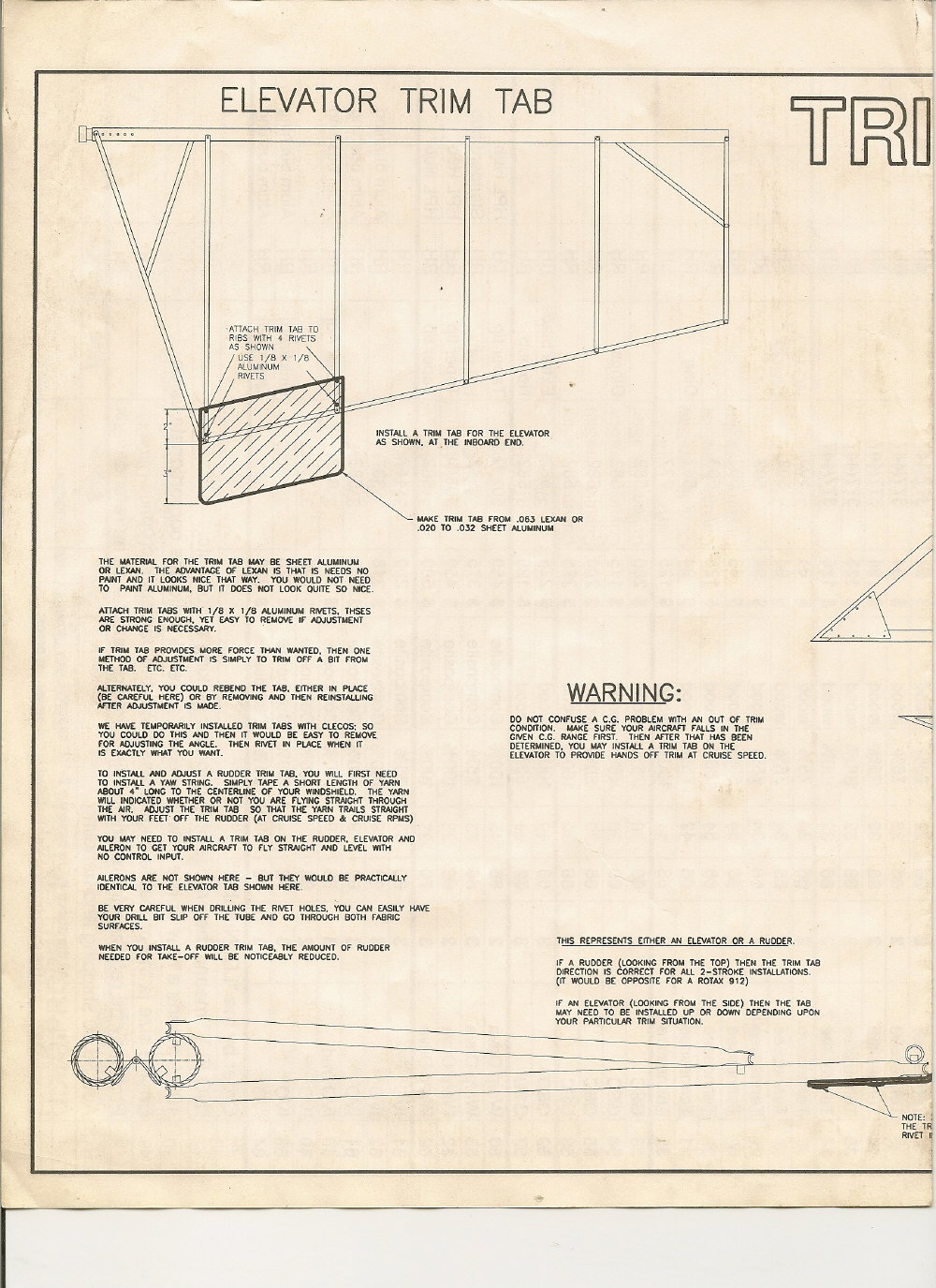

I'm not trying to offend anyone by giving my opinion. Dropping the ailerons together will work as trim. Here is another way that will work, your choice. See print attachments.
Respectfully,
Dennis Baber
Cape Coral, Fl
baberdk(at)gmail.com (baberdk(at)gmail.com)
Stay Curious

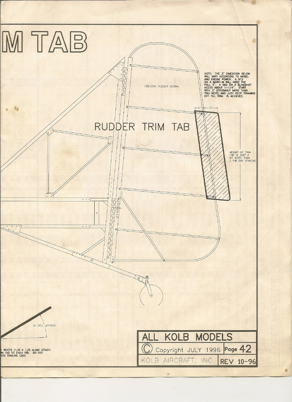

I found another solution to the aileron trim tab. This guy has his trim tabs move opposite direction of his trim tabs. See attachment:
Respectfully,
Dennis Baber
Cape Coral, Fl
305-814-7218
Stay Curious
