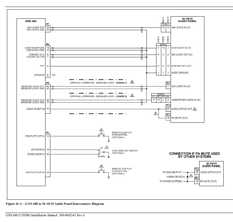

Thanks Tim. My confusion is over the fact that there are 5 pins in the SL30 and only 4 in the PMA8000 for the Com 1 radio.
I think the solution is to run both the SL30's pin 13 (audio ground) and pin 7 (mic ground) to the PMA8000 pin 10 (com 1 lo).

Tim Olson
Joined: 25 Jan 2007 Posts: 2882
Posted: Fri May 04, 2007 9:03 am Post subject: Avionics Wiring: SL30/40 to PMA8000 |
Page 19 of the SL-30 manual shows something similar when wiring to an
LS-10/15 audio panel so I see no problem there.
