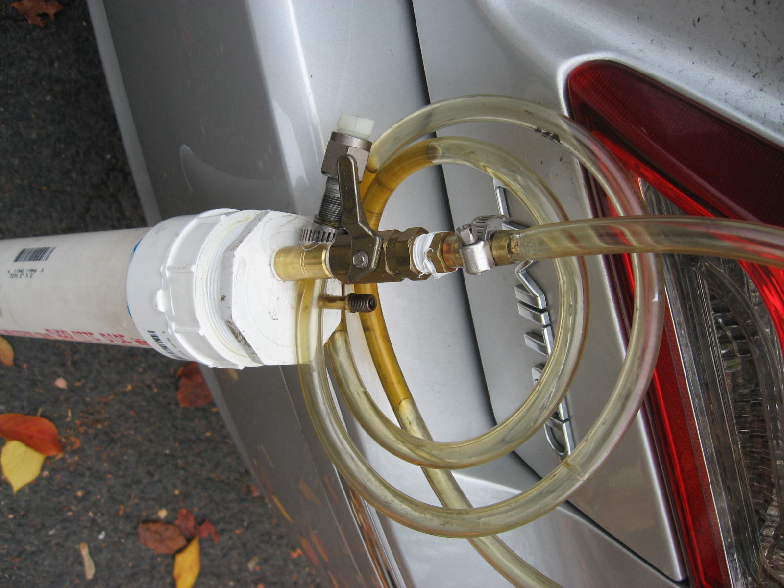

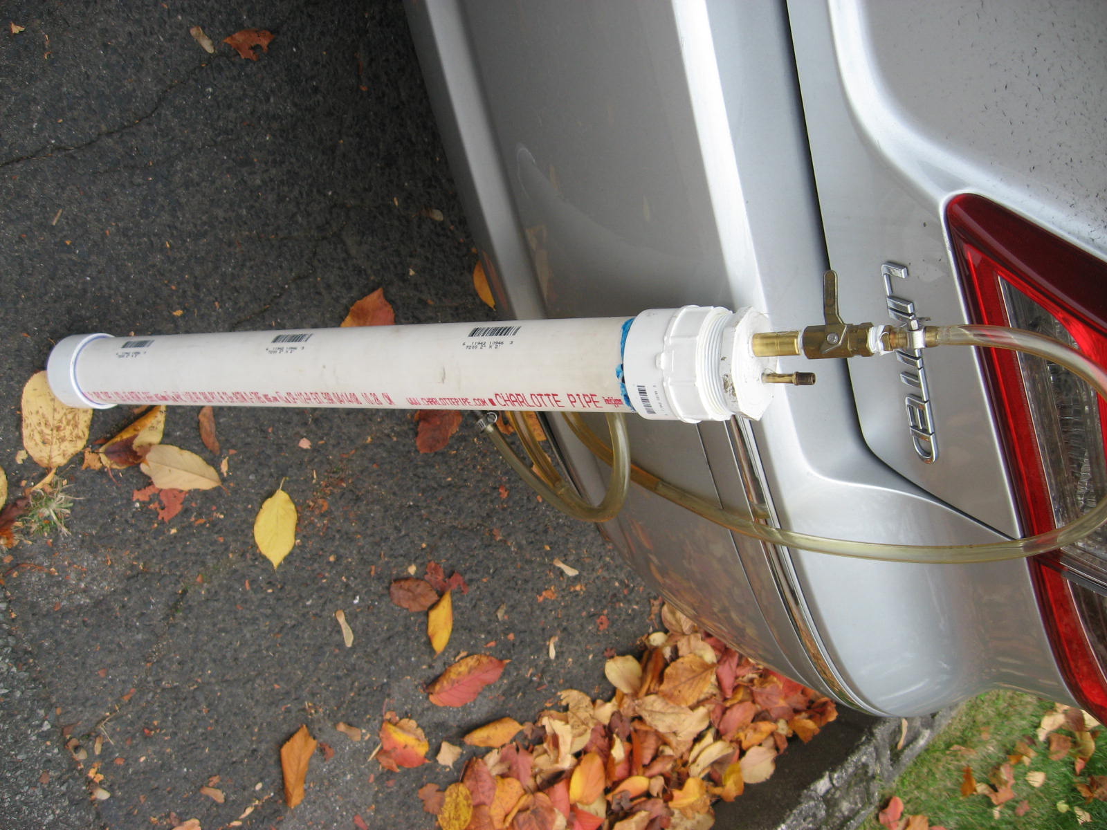

PostPosted: Wed Nov 07, 2012 12:45 pm    Post subject: Problems with Tanis engine preservation kit Reply with quote
Alan:
Here is a picture of a very simple Pre-Oiler that I made. Cost, less than $20.  $40 if you consider the cost of a air pump.
The top is screwed off to pour in the oil. (1 Qt)
Then it is pressurized to 100 - 125 PSI
Plug the Engine with a cap.
The end of the clear plastic tube is connected to the IN side of the oil cooler
and -
Then plug the oil cooler with the cap.
Then connect to the OUT side of the engine.
This will squirt the oil around at the same pressure ans a running engine.
Drain (1 Qt) from the bottom of the sump and reuse it.
I have used this method 4 times so far and the engine looks great when inspected with a bore scope.  Mater of fact - THIS is more oil saturation than most planes get in two or three months... Think of it this way:  Look at the planes on the field.  How many of them do you see flying?  So this type of oiling is very good for your plane.
Barry

eschlanser
Joined: 08 Apr 2010
Posts: 60
PostPosted: Tue Nov 13, 2012 4:30 pm    Post subject: Re: Problems with Tanis engine preservation kit Reply with quote
Barry,
Maybe it's only me as I have a hard time following directions (just ask my wife) but I can't follow the IN's and OUT's of where to plug what in order to hook up your clever pre oiler. Can you try again to explain the hook up? Slowly this time, please.
Eric - O-320 preserved in SW Michigan.
ps - Do you have a picture of it hooked up to the engine?

Barry:
When you disconnect ONE side of the oil cooler you will have a Male fitting on the oil cooler and a hose...
Now disconnect the hose.
You now have a Male fitting on the engine.
You will need a CAP (usually an ANxxx-6) CAP
Now, on the Pre-Oiler you will have a hose/tube - It will require a Female ANxxx-6 fitting to fit on the Oil Cooler and on the engine.
Fill the Pre-Oiler with 1 Qt of oil.
Connect the hose/tube to the Oil Cooler
Put the CAP on the engine fitting.
Pressurize the Pre-Oiler to 125 PSI with air.
Leave the air hooked up and running.
Open the valve on the Pre-Oiler.
BAM - You just squirted oil through the engine.
NOW!
Shut off the Pre-Oiler.
Disconnect the air.
Remove the CAP from the Engine.
Remove the hose/tube from the Oil Cooler.
Put the CAP on the Oil Cooler.
Connect the hose/tube to the Engine.
Put 1 Qt of oil in the Pre-Oiler.
BAM - You just squirted oil through the engine IN OPPOSITE DIRECTION - GREAT!
BAM - You are DONE
Hope this makes sense - If not, let me know and I'll try again.
Barry

Barry,
quote="BARRY CHECK 6"]Alan:
and -
Barry

Barry,
That should do it. I am eager to give it a try.
Thank you,
Eric
