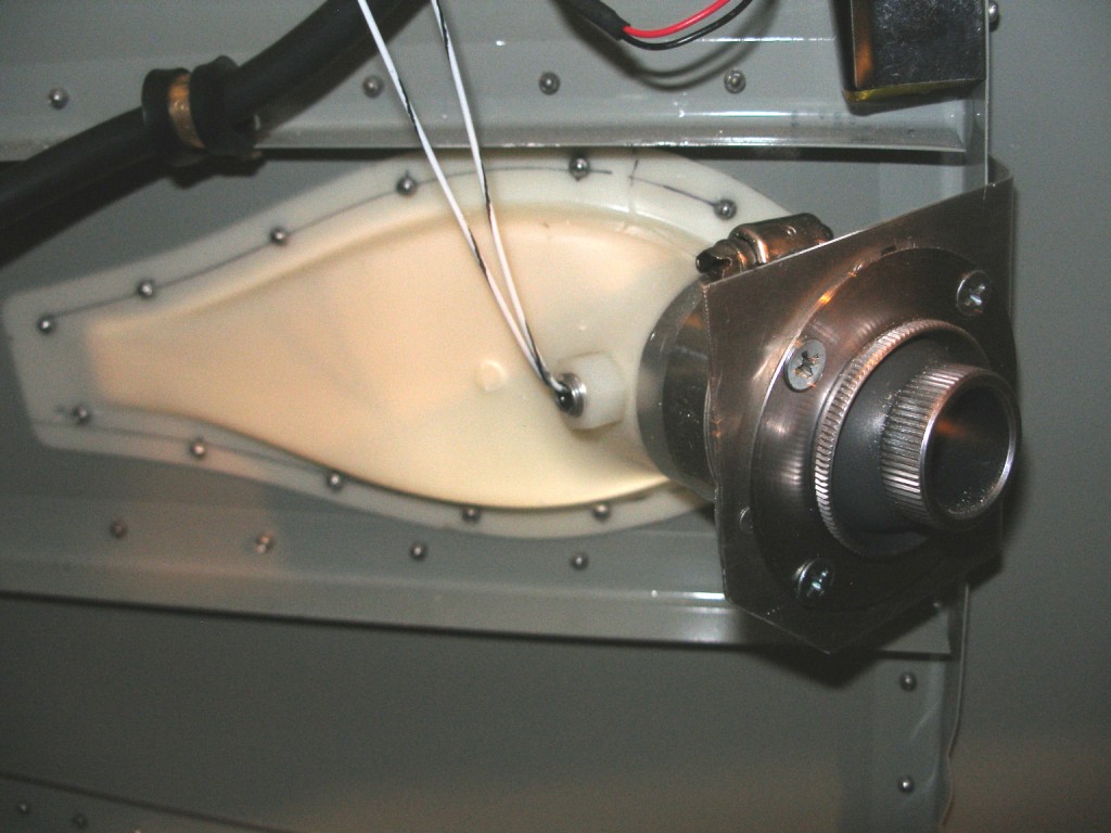

I mounted my OAT probe inside the right NACA intake fiberglass molding.  I figured it would have adequate outside air, not be affected by cowling temps nor the exhaust stream and would be out of the sunlight. It is also a short wiring run from the probe to my Dynon, which has an OAT readout. .
Jay

PostPosted: Sun Jan 09, 2011 1:33 pm    Post subject: OAT Sensor Reply with quote
That's where I put mine also.

PostPosted: Mon Jan 10, 2011 1:49 pm    Post subject: Re: OAT Sensor Reply with quote
Thank you.
I think I will go with the inlet position. This will keep the wiring short and also out of the way.
