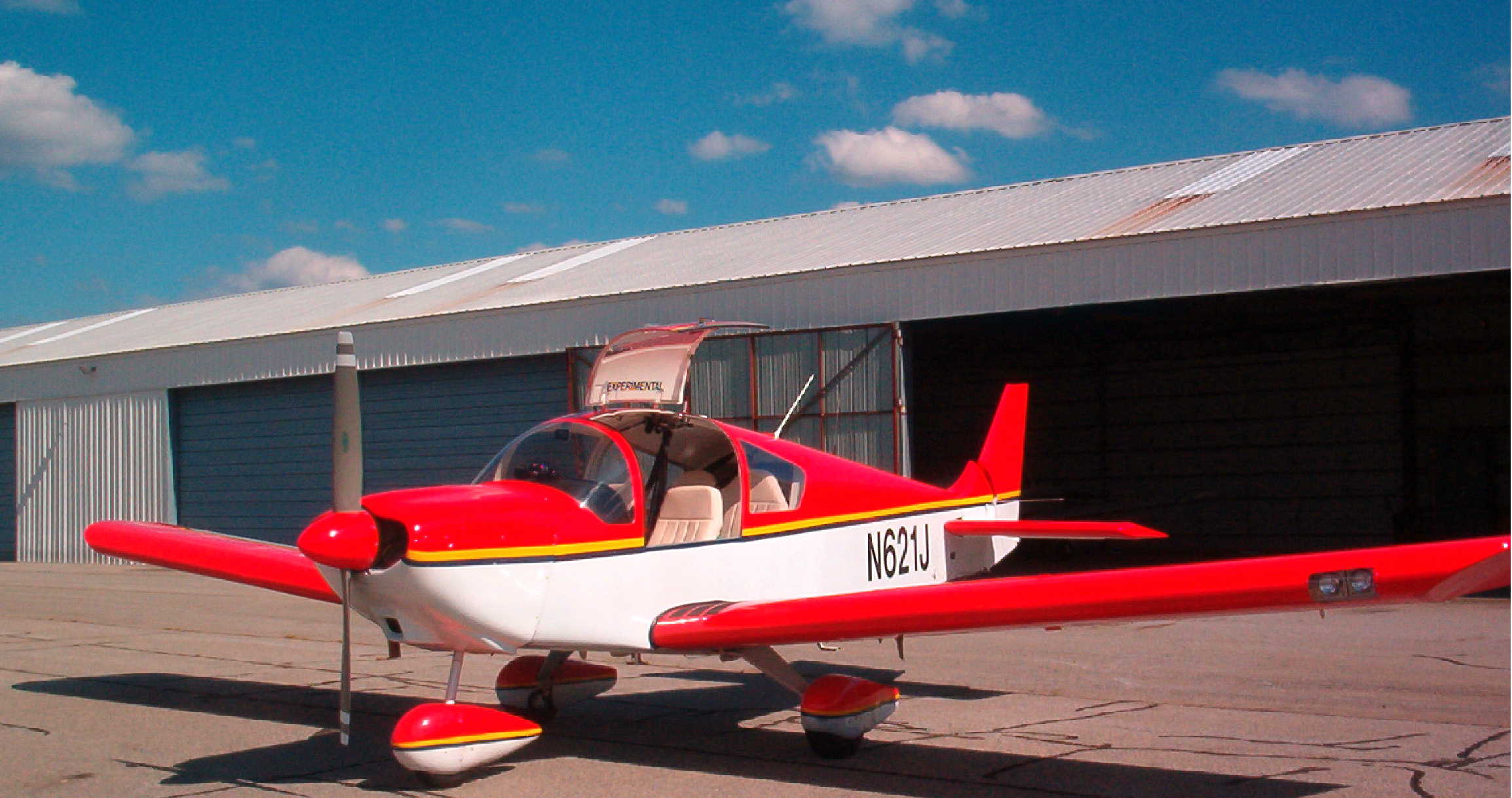

PostPosted: Thu May 04, 2006 3:52 am    Post subject: Re: Paint Reply with quote
I also used the AFS paints, mainly for the safety issues, it's not flammable, and it's easy to clean up.
