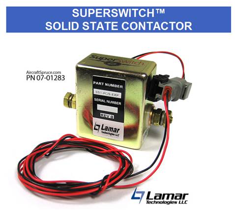

Hello,
Has anyone had experience with the solid state contactors from Lamar Technologies they call a SuperSwitch? See this Aircraft Spruce link for info:
http://www.aircraftspruce.com/catalog/elpages/superSwitch.php
I know they’re expensive – but, we’re already in that category of contactor with the need for 28V high continuous current contactors (100 A alternator, all electric A/C). We already have very nice Blue Sea high capacity contactors that are hermetically sealed (~$150 each). They weigh about a pound each, though, and the significant weight savings with these solid state contactors looks good.
I’d appreciate comments and advice.
Valin Thorn
Legacy
Houston, TX USA
Exerpt of info on web link:
Features
  • Up to 66% lighter weight
  • 99% more reliable
  • 5 to 44 volt operating range
  • Replaces all mechanical contactors
  • Solid state technology
  • No moving parts
  • Up to 600 amps momentary operation
  • Up to 100 amps continuous
  • Negative or positive turn on
Specifications
  • Input: Input control current 5 to 44 volts
  • Output: Operating DC voltage range 0 to 44 volts
  • Maximum continuous current 100 amps
  • Maximum surge current (IDM) - .1mS: 1200
  • Ambient operating temperature range: -40 C to 85 C
  • Weight: Uni-directional .3 lbs
  • Bi-directional .5 lbs
  • Encapsulation: Potting or conformal coating
 Filesize:  28.06 KB
 Viewed:  14173 Time(s)
PostPosted: Sat Mar 06, 2010 3:40 pm    Post subject: Solid State Contactors -- SuperSwitch? Reply with quote
At 03:04 PM 3/6/2010, you wrote:
Hello,
This same question came up a few years ago
http://www.matronics.com/forums/viewtopic.php?t=26571
I'd not heard of them at that time. I did write to Lamar
asking for an engineering data package that would help
me evaluate the potential for incorporation onto TC
aircraft. As I recall, I got an answer from somebody
in sales who promised to forward my request to the
right individual.
Never heard back and I guess it slipped my mind.
I just did an advanced search on "superswitch"
limited to http://www.lamartech.com/ and the
search engines did not return a hit. Did anohter
search on "07-01283" and "lamar". Got hits on
Aircraft Spruce and Skyshop in Australia.
Searched the whole constellation of matronics forums
and got two hits . . . THIS thread and the one I
cited above from some years ago. So I guess
the short answer is, haven't got a clue as to
how good the product is (although Lamar is
usually a low risk choice for other things).
It doesn't appear that they've made much of
a splash in the marketplace.

PostPosted: Sun Mar 07, 2010 5:34 am    Post subject: Re: Solid State Contactors -- SuperSwitch? Reply with quote
Solid state contactors might have a small leakage current when they are off.
Joe

PostPosted: Sun Mar 07, 2010 2:47 pm    Post subject: Solid State Contactors -- SuperSwitch? Reply with quote
Haven't used these, but they look identical to Teledyne's. $$ to donuts that the manufacturer is the same.
http://www.futurlec.com/RelSS.shtml

[quote] If you are planning on using one of these devices in your airplane, make sure you purchase the ones for a DC load. Some of the ones for AC load, require a zero crossing to switch and will not work for DC. Roger [b]

PostPosted: Mon Mar 08, 2010 9:28 am    Post subject: Solid State Contactors -- SuperSwitch? Reply with quote
At 09:41 AM 3/8/2010, you wrote:
good morning Bob
I was hoping you would offer some comment on these devises. Pros / cons / etc
I've not seen detailed engineering data on any such
products to date. Certainly, the technology exists
to fabricate solid stage contactors. I think the
race car hobby/industry has been flirting with them
for some years.
My personal knowledge as to the performance of
products currently offered for sale is zero. I
would be interested seeing the detail data sheets
and/or doing lab tests on a device to look at
things like on-resistance, off leakage, transient
immunities, conducted noise, performance at temperature
extremes.
We KNOW that hard-metal contactors have VERY good
OFF and ON switching characteristics. Further, they're
simple, rugged and offer good value (service life and
performance vs. acquisition costs).
So the short answer is that pending further enlightenment
on my part, I'm not able to offer any insight.
