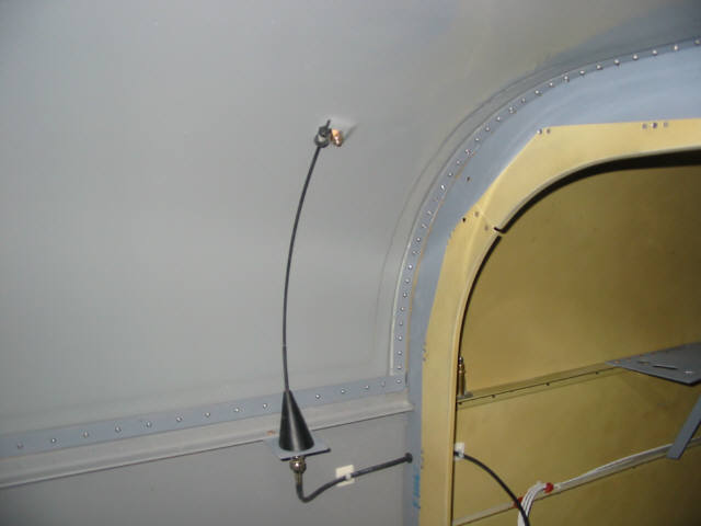

I put my ELT antenna in the right aft corner of the baggage compartment. I riveted a small .063 plate with a hole in it onto the .125" aluminum angle. I attached the antenna to that plate. I glassed an AN3 bolt onto the inside of the canopy top just above and used this to bolt on a cushioned clamp that secures the top end of the antenna. Since my ELT is just behind the baggage compartment bulkhead there, the antenna wire run is all of about 3'.

Attached is a picture of the antenna install. I just have a digest subscription, do pictures get forwarded out to the list?

Looks nice.  Anyone want to comment on how well the signal can get through the cabin lid?

As posted last night, I talked to Airteck about this and they said there should be no problem with a vertically mounted antenna under fiberglass.  They were concerned that a horizontal mounting under the rudder, as many have done on RVs, would seriously degrade the antenna.
