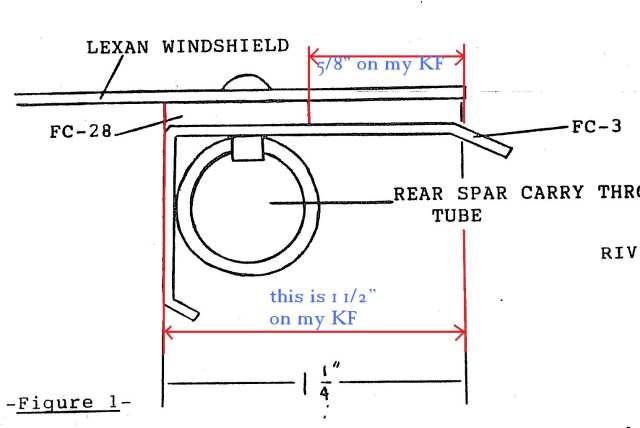

I re-read it two more times, everything is indicating that the minimum required 1 1/4" is measured from the front of FC-3. Do you have 1 1/4" of lexan that overlaps the turtle deck? Can I get a quick poll on this from a few people? I can certainly see that the extra would help keep everything together.

James. Looking at Lenoards drawing C " frrom the front of FC-3 overlap" would not give you 1 1/4 overlap of the turtle deck. It would give you 1 1/4" minus the width of FC-28. Leonards drawing shows that dimention to be 5/8".

I re-read it two more times C everything is indicating that the minimum required 1 1/4" is measured from the front of FC-3. Do you have 1 1/4" of lexan that overlaps the turtle deck? Can I get a quick poll on this from a few people? I can certainly see that the extra would help keep everything together.
OK as I said the DRAWING is hosed... use it a REFERENCE to give you a visual on the fix... the written description states
The leading edge of the turtle deck must engage the skylight with a minimum overlap of 1 1/4"
This does not say from the edge of yada yada, it states OVERLAP period. Go by the written letter not the drawing and you cant go wrong.
I put this on mine as I did not feel like having an in-flight air-conditioning system self activating at inopportune moments.

This is an unfortunate circumstance where the "picture guy" and the
"dialogue guy" did not get on the same page...literally....before
this Service Bulletin went out.
It's too bad too, because it leaves us builders to try to figure out
if the situation calls for the 1 -1/4" overlap of turledeck and
skylight, or the "apparent" 5/8" of overlap as shown on the drawing.
What do we follow...words or picture?
Just to interject my own situation, I followed the *Kitfox* drawing
and dialogue, and mine came out closer to the 5/8" dimension. I have
not had the trouble that James has had and I do a LOT of slips to
both sides.

Excellent! Now this is perfectly clear. However, I must point out that the markup did

Len C Thanks for info. I made my 2 piece windshield cabin top same as original it has about 5/8 " overlap. Guess I'll have to install the aluminum overhang addition to be safe. Hard to believe 5/8" isn't adequate.

Perfectly clear, but is this 1-1/4" dimension really needed? The
Kitfox seems to work ok with the 5/8" overlap, and this is the first
time we've (I've, at least) heard of the turtledeck blowing out...or
is it? Somebody with more time in type and on this list should be
able to answer this question. Is there a Service Bulletin out on the
Kitfox? Remember this is an Avid Service Bulletin. I'm not saying
anything bad about Avids, just trying to understand why no SB on a
Kitfox, if indeed there are none.

On Feb 15, 2009, at 7:04 PM, Paul Franz wrote:
On Sun, February 15, 2009 2:38 pm, akflyer wrote:
> marked up the PDF and reposted
that the markup did
not get distributed to the e-mail list but it appears in the forum
posting just fine.
click this link to see Leni's (Snakeman's) perfectly clear markup.
<http://forums.matronics.com/download.php?
id=14596&sid=7a9dbd247008ae785633dd9eb88241c2>
> DO NOT ARCHIVE
> Leonard Perry aka SNAKE
> Soldotna AK
> Avid &quot;C&quot; / Mk IV
> 582 IVO IFA
> Full Lotus 1260
> #1 snake oil salesman since 1-22-2009
> hander outer of humorless darwin awards
> http://forums.matronics.com/viewtopic.php?p 30404#230404
Paul Franz
425.440.9505 (O)
425.241.1618 (C)
Lynn
Kitfox IV-Jabiru 2200
N369LM
Lynn Matteson
Posts: 2778
PostPosted: Sun Feb 15, 2009 6:07 pm    Post subject: New issue, turtle deck security Reply with quote
Hard for me to believe too, Pat, but remember that this is an Avid
Service Letter, *undated*, and refers to slips with the door open.
Maybe this was released before Kitfox broke away from the "parent"
organization, and Kitfox strengthened something after this, rendering
this SL non-applicable to the 'fox.
Lynn Matteson
Jabiru 2200, #2062, 605 hrs
Sensenich 62x46
New skis done and flying
On Feb 15, 2009, at 8:47 PM, patrick reilly wrote:
Len, Thanks for info. I made my 2 piece windshield cabin top same
isn't adequate.

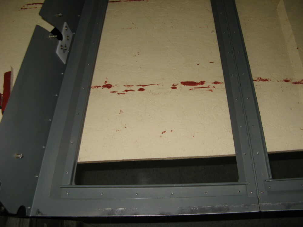

We pulled the turtle deck off and reinstalled it and the front edge of it buts all the way against the metal strip which holds the gap under the window. All DZUS fasteners (camlocks?) were installed and are as snug as I would expect. So once again I am here with no ideas how to go about fixing this, or even if there is something to fix. I am not sure what could have caused this to happen. Any help is appreciated.
James
James, I just now went out and looked at my turtle deck. Mine is a Classic 4 and I have never seen a Model III in person. It may be different than a 4. I see no way the leading edge can come out from under the skylight trailing edge without some significant permanent bending.
Attached is a picture of the inside of the leading edge on a Classic 4 turtle deck. Note the notch in the lower left where it fits around the rear spar carry through. Also the stiffening angles riveted to the inside of the deck. The camlock on the side near the leading edge.
The wear marks where it has been fitting shows 5/8 inch overlap under the skylight lexan.
Is it possible your turtle deck was installed with the leading edge on top of the trailing edge of the skylight by mistake before the flight?
I would not hesitate to install the mod posted for the avid if you can't find a logical reason for what happened. It would be good to hear from some model III owners on this.
Edit,:Sorry about the wide picture, can't seem to fix it. Sometimes this forum is a mystery to me.
 Filesize:  94 KB
 Viewed:  40603 Time(s)
Tom Jones
Classic IV
Ellensburg, WA
sbennett3(at)aol.com
The attachment is actaully here:
<http://forums.matronics.com/files/turtle_deck_132.jpg>
Rather than the improperly shown link in the e-mail distributed to the KF List:
http://forums.matronics.com//files/turtle_deck_603.jpg
Something goofy happens when a forum post with a picture gets sent to e-mail. Notice
the extra forward slash in the posted link? Just enough so that the matronics web
server can't resolve the file location.
