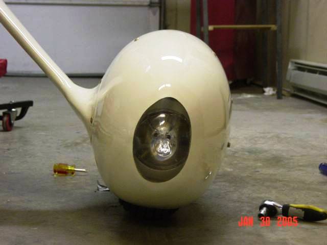

Attached is a front view of my landing lights embedded into the front of
my main gear fairing.
I operate out of a grass strip, have 250 hours on the tach, and have had
no problem with the landing lights taking the landing vibration - what
little there is, of course - since the motorglider alights as gently as
a feather! Wink Wink

RobNeils(at)Q.com
PostPosted: Sat Jan 03, 2009 5:48 am    Post subject: Landing Lights Reply with quote
Trev,
Because N128HW ( 2I, too, ate Hotel Whiskey!) is a motorglider I took special precautions to decrease drag as much as possible.
I looked everywhere for the best gear leg to wheel fairing and found nothing - not on the web and not at airshows.
After cogitating, scratching head, drinking beer and facing East, the muses wre enticed and they spoke, 2Make the gear leg bell-bottomed. 2 Thus evolved a simple solution to getting a low-friction but high-strength intersection. The bell-bottomed shape at the end of the gear makes it very easy to afix the wheel fairing. Afix blue foam to the bottom of the gearleg and shape the beel-bottom. Having previously built or bought the fairing, use double-sided tape to stick sandpaper to the fairing where it will connect to the bellbottom. Rub the fairing agains the bottom of the blue foam to get an exact contour. Fibberglass the bellbottom and cut it to a pleasing shape. Carve out or dissolve the blue foam.
Drill through the bell-bottom into the fairing to make screw hole. Afix nutplate to the inside of the wheelfairing wherever there's a screw hole. This set-up makes it easy to afix and disassemble the wheel fairing from the gear leg.
To get a smooth transition afix duct tape around the edge of the bell-bottom. Slather dry miro onto the wheel fairing / bellbottom joint. Let cure long enough to carefully cut arround the bellbottom with a razon blade so you can release the fairing from the bellbottom. Allow to cure completely. Sand down the edges as needed.
P.S. The landing lights are fully aim-able.
Rob
