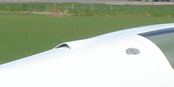

PostPosted: Wed Sep 10, 2008 7:40 am    Post subject: Cabin vent - air outlet? Reply with quote
After consulting with EA2004 about any possible strength issues (none), I
built an air outlet vent on top of the fuselage behind the doors - see
attached photo. This is a low pressure area.
Under the fore part of this vent is a 2 inch hole through the fuselage. I
built a sliding valve under the hole to partially or fully close the
opening. I have, however, during two years of flying never adjusted this
valve from full open, whether in summer time or during the winter, so I
consider it unnecessary to have it. Air flow through the cockpit is instead
controlled only by the fresh air or heater inlets (either ones always open
to some extent).
Svein

You say the area where you placed the outlet is a low pressure area. Are you
sure? Did you measure that pressure? I think when the profile is diminishing
the pressure raises. On that place I have an intake for ventilation and even
in hot days I can't open fully the inlet because the windstream can't be
endured for a long time.
Karel Vranken. F-PKRL
frans(at)paardnatuurlijk.
PostPosted: Thu Sep 11, 2008 12:25 pm    Post subject: Cabin vent - air outlet? Reply with quote
[quote:67f80f7028="stevenwpitt"]
I have fitted Ian's mod and it also appears to work as I do not have the
tugging shirtsleeves from the doors. My only comment about positioning is
that if you go below the 'd' in the bulkhead, if you travel any distance
with luggage this blocks the outlet. The positioning is a compromise.
Steve Pitt
G-SMDH
-----[/quote:67f80f7028]
I was thinking about putting it in the top of the bulkhead. As I have a hi-top, there is excess space above this 'D'.
Frans
Visit - www.EuropaOwners.org
sidsel.svein(at)oslo.onli
PostPosted: Thu Sep 11, 2008 1:33 pm    Post subject: Cabin vent - air outlet? Reply with quote
Karel,
No, I have not measured the pressure, I relied on what EA2004 said also
about the pressure in this area. I think they were correct, because the air
speed over the top is higher than the airplane's speed through the ambient
air and hence the pressure is lower than the ambient pressure (compare the
fuselage profile to a wing profile - higher speed hence lower pressure on
top of the wing).
All I can say for sure is that the pressure at my vent outlet is lower than
in the cockpit, because air goes out through that vent (I can feel the air
flow by holding my hand under the outlet opening). The air pressure in the
cockpit may be higher than ambient, though, because of the efficient NACA
intakes on both sides (built as per Europa standard). If air comes in
through your vent, it must mean that your cocpit pressure is lower than at
your top vent opening. Where does this air leave your cockpit?
Svein
