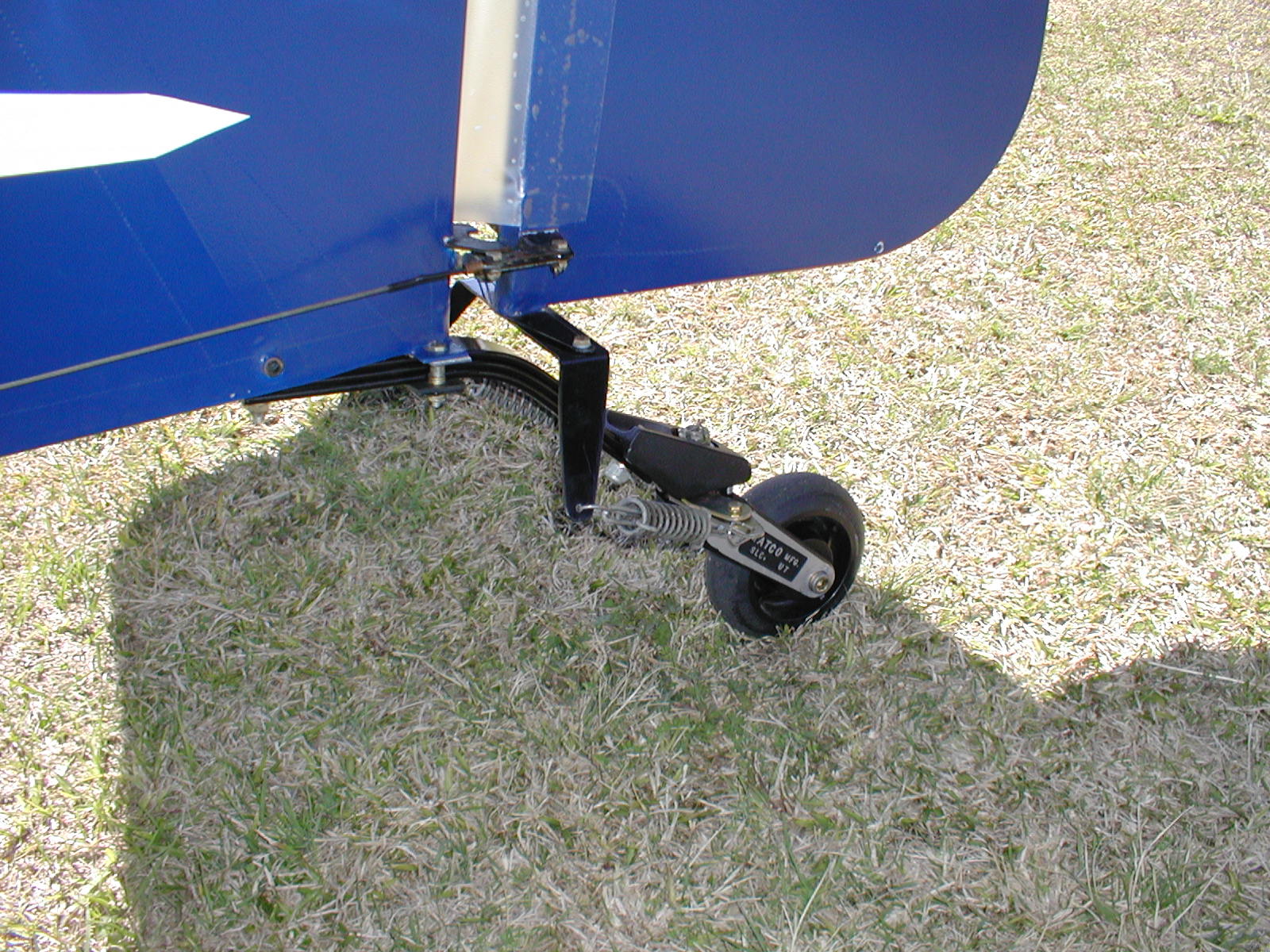

I did get my aircraft up and running again last friday and managed to finish up my endorsement. The tail-wheel is relatively straight, but you can see that the leaf spring is twisted a little. Is this a standard item I can order from Kitfox, or does each builder find their own tail-wheel system?
Also, I was wondering about the attach points. The airframe and the front bolt seem very strong, but the two tabs on either side of the tail seemed very easy to bend back in place, and the bolts seem very thin. Has anyone beefed this area up a little? Just wondering if it wouldn't be better to add a stronger backing plate underneath the tabs and then also beef up the plate on the bottom of the leaf spring.

Th e tabs you mention can break. You can double up the tab if you like or just watch for hailine cracks to start.
I would replace the tailspring with the 3 leaf one that Mc Bean sells.
Works great for me.

At 06:35 AM 8/12/2008, you wrote:
| Quote: | Also, I was wondering about the attach points. The airframe and the
I've never heard of a failure of the tailwheel support
structure. On mine the rear tabs and bolts only restrain the spring
laterally. I put tubes on the bolts so the spring would fit tight
laterally and the plate would bolt up tight against the tubes,
slightly clamping the spring. It's been working great through
rigorous testing for the last couple of years. (Off-road, on-road, a
couple of mild ground loops, and one interesting impersonation of a
helicopter.)

Guy, many years ago I had one of the tabs break off on my Model II.
Actually, I didn't notice it until preflight so I have no idea how long it
had been broken, but I feel it probably broke on my last landing. From the
look of the rust on the break, I think it had been breaking for awhile. I
simply welded it back on then added a doubler to the underside of the same
thickness. No more problems.

After bending it back and forth, I'm going to guess that the cracks are already started. How did you attach the doubler, and what did you make it out of? Seems like a hard place to do welding with the fabric and everything right there.

| Quote: | | How did you attach the doubler, and what did you make it out of? Seems like a hard place to do welding with the fabric and everything right there |
I did mine a few years ago in the winter -- outside.
just welded around the doubler to the existing tab that I welded in place first. your fabric will have be replaced and re painted. Not a big job , but it will have to be done.

Since I am not welding the tab back on, but just trying to reinforce it, would some sort of epoxy be an acceptable method of attaching the plate?

I too broke my tail wheel tail spring+the tab that is welded all so..so
I made a thicker tab bracket twice as thick,and welded it in to
place..and then could not find tail spring that would fit right..So i
made my own out of spring steel.formed and shaped with a shop press..and
drilled double spring..And it works great now.....Steve Shinabery

| Quote: | Since I am not welding the tab back on, but just trying to reinforce it, would some sort of epoxy be an acceptable method of attaching the plate?
Sure it would hold , but for how long ? I would say not very long.
I think welding might be your only option.

That would probably work OK if you added a few rivets to it.

When mine broke it was right beside the weld so in that case you could only rivet to one tab and there would only be one weld holding on the remains of the original tab so it would be liable to break again.
Sorry -- but welding would be best way to go.
The problem with reinforcing the plate from below is that you have to
space the whole spring down, (or get a custom spring, or change the
angle.) This increases the leverage on both the front and rear
mounts, which kind of defeats the purpose of the reinforcement. To
answer your question, however, I'd say sure, give it a try. The worst
that can happen is that the bond breaks. From what I understand of
what you're trying to do it won't go anywhere and you'll have most of
the additional strength anyway.

Ryan,
I was having difficulty steering my 4 on the grass with my fat tires so I took about a 3/16 inch piece of steel cut and bent it kind of in the shape of an inverted W without the center in the W if that makes sense. It runs straight across . I drilled 2 holes and bolted it to the exsisting holes in the rudder tabs. Then I drilled holes at the ends of the ears and attached my rudder cables there. This adds reenforcement to the rudder tabs and gives me more mechanical advantage to turn. I have seen this on old Pipers where the rudder actuating bars are bent down.
Dick Maddux

I'm not following you Dick. Maybe you could post some pics?

Dick,
I got your picture. I see what you are talking about now. We are talking about two different things; The leaf "springs" are the three pieces of steel that link the fuselage to the tail-wheel assembly, not the connector/anti-shimmy springs that connect to the rudder. The tabs I am going to reinforce are the ones on the very end of the fuselage not the rudder. From the picture it actually looks like you might have a reinforcement plate under the tabs as well (unpainted metal between the tabs and the leaf springs).
