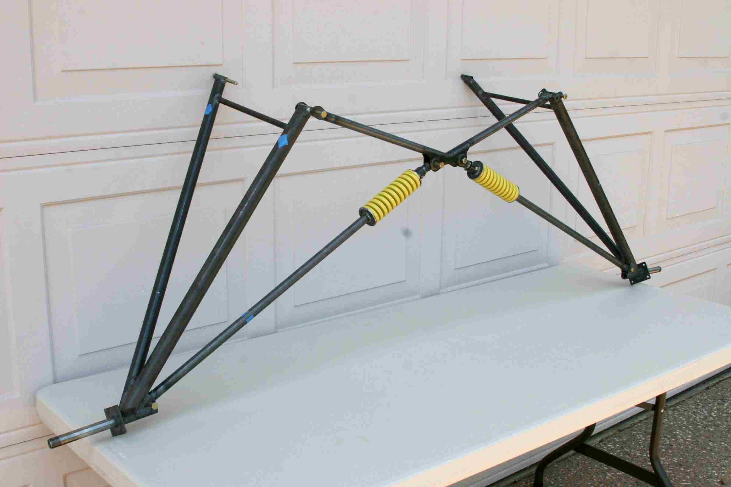

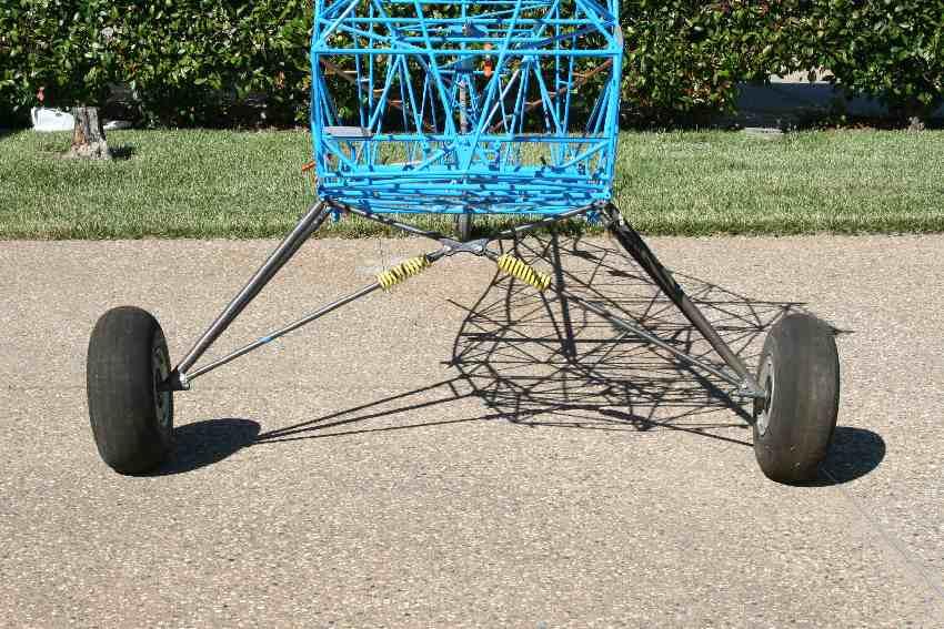

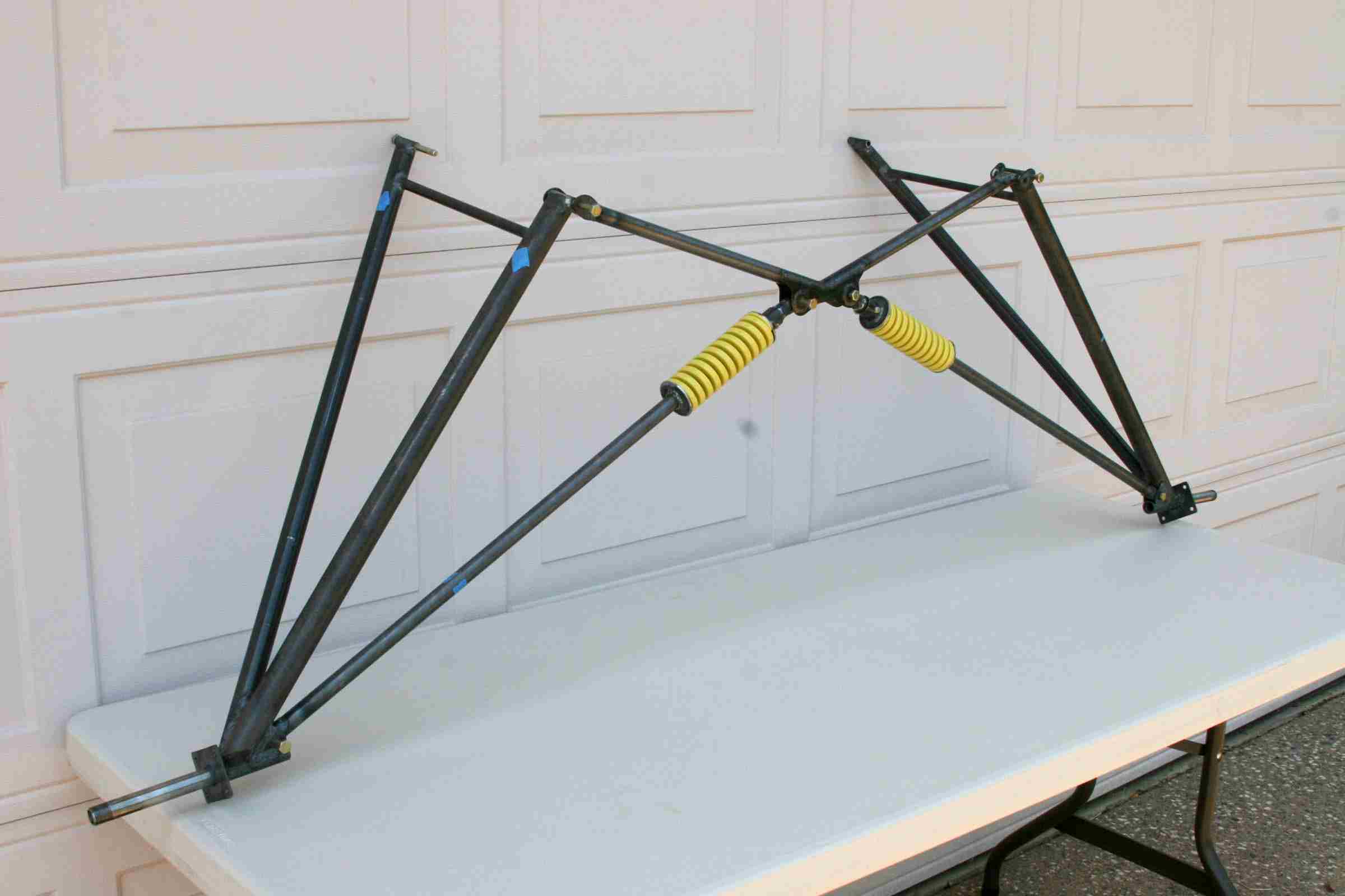

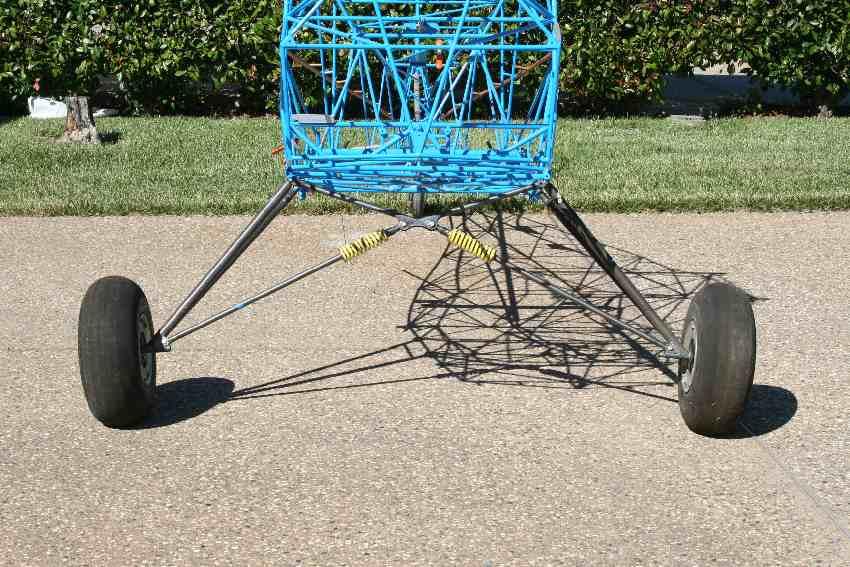

To the list:
I am back bulding again. I never thought I would do it again since flying
superceded the build experience, but then when there is no airplane....
Thanks to the local grapevine, I found a 1992 partially completed kit. It
was outfitted for the 582, so I have some parts that are available. I am
currently working on all the things I learned to wish I had on the original.
Just finished a cabane attached compression spring landing gear. It comes
in at about 8 lbs under the grove gear weight and I like that. It has a
wider stance and is a bit taller than the grove gear. The other major mod
is the elimination of the upper false ribs, replacing them with an aluminum
leading edge from the PVC leading edge aft to the stringer. I hope to
someday actually begin working on the airplane. Pictures of the landing
gear attached.
Glad to be back and active.
Lowell Fitt

PostPosted: Sat Jun 21, 2008 4:24 pm    Post subject: New Model IV Reply with quote
Good news Lowell!
I like the looks of your gear. And the dimensions. And the weight. I can
assure you though that the Grove gear is tough!
Randy

PostPosted: Sun Jun 22, 2008 2:42 am    Post subject: New Model IV Reply with quote
Hi Lowell-
Nice to hear from you.
It may just be all the shadows or the angle at which you took the
shot, but it seems like there are more structural members within the
fuse of your plane than normal. Is that just an illusion, or did you
add some reinforcements?

PostPosted: Sun Jun 22, 2008 1:15 pm    Post subject: New Model IV Reply with quote
Thanks to all for the welcome. To Lynn, this is the typical Model IV. I
guess with a bright sunny day and lots of contrast it makes it look busy.
Actually, though, from the advice of friends, the turtle deck area has been
modified to allow the shoulder straps to attach directly behind pilot and
passenger. I always struggled keeping the shoulder harness from dropping
off my shoulder. Repositioning the center lug also makes the baggage area
more accessable.
Lowell

PostPosted: Mon Jun 23, 2008 1:38 am    Post subject: Re: New Model IV Reply with quote
Lowell, Welcome back and I love you gear. Your cub type gear is awesome. Looks like a cheaper and light alternative to the grove gear.
Will you be selling it ?

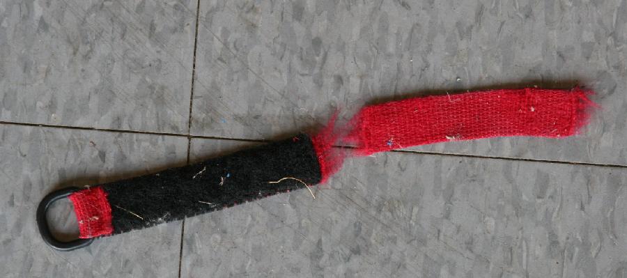

lcfitt(at)sbcglobal.net
PostPosted: Mon Jun 23, 2008 5:40 am    Post subject: New Model IV Reply with quote
Lynn,
I did exactly the same thing, but with 1" red nylon webbing. I worried at
times if it would be hard to get out of in the event of a crash and fire.
It is interesting that in our hard landing, the nylon just came apart. What
I mean is the webbing shredded.
Lowell

Lowell-
Shredded? Wow, that must have been some hit. Did you sew the red
webbing, or velcro it? With the velcro, it should have just popped
the velcro loose, I would think.
The more I think about how I did mine, the less sure I am about the
safety issue....I might just get turned sideways and slip through the
shoulder harness and get up close and personal with the panel....time
to revisit this situation, I think.

just came apart. What I mean is the webbing shredded.

Lynn,
The strap had velcro on each end with a small "D" ring for grabbing in an
emergency. Picture of what was left attached. Yes it was a hit.
Lowell

PostPosted: Mon Jun 23, 2008 5:49 pm    Post subject: New Model IV Reply with quote
Pat,
I would be happy to help. I have a meeting to go to tonight and can give
some dimensions tomorrow. I'll tell give you a brief discription how I did
it. A friend gave me some basic measurements - height above the ground -
forward end of the forward mounting boltto the ground and the and track. I
then fixed the fuselage on a sawhorse level at that height and secured it.
I removed the tires and using the bare axles, I dropped a plumb line and
marked the floor exactly below the ends of the old tube gear. A line was
drawn through those line to give a fix on the wheel contact line in a fore
and aft direction. Then a plumb line down from the center of the fuselage
to give a center point on the wheel contact line. The total track was then
marked on that line to give the relative position of the ends of the axles.
I then used two lengths of 1X1X1/8" angle extending beyond the widest marks
on the line and welded a length of angle between them about 10" long. I now
had two parallel rails that were fixed to the floor with bondo with the line
between them. The plan is to use the rails to make fixtures on trollys that
fix the angle and location of the axles. Of angle iron and wood, I made
spacers about 1.3" high that rode on the rails essentially extending the
rail height that 1/3 inch. Then using tubing that exactly fit over the
axles, I welded up fixtures of angle iron that rode on the spacers to fix
the angle and location of the axle.
After the fixtures were finished. I removed the old landing gear, tapped out
the axles and using the fixtures without the spacers and mounted at the
appropriate distance on the rails positioned the axles at the desired
location for the new landing gear. The rest amounted to using the axles
mounted to the fixtures on the rails and the fuselage as a jig and cutting
and welding everything in place. Of course tack welding and then removing
to bench top height made the welding easier. I found that starting at the
axle and then working to the pivot points on the tops of the legs gave a
more accureate reslult given the warpage typical with welding.
The cabane strut was made pretty much the same way. I will send some detail
photos. For the spring strut, I used 3/4" .049 tubing and it wasn't until
after finishing the struts that I learned that the spring strut made for my
friend was 7/8 .049 tubing. These struts are commercially made and are
designed for airplanes heavier than the Model IV. I will stick with what I
have, but may go to the larger tubing if I make another set. The springs
themselves are available from Aircraft Spruce in their catalog. They are
heavy puppies and cost abour $90 per set.
I'll take a couple of photos of the jigs and track and send them also. Also
when welding up the final gear legs, I drilled and tapped holes in the jigs
through and into the tracks and placed bolts in them so nothing would move.
Questions - just ask. I doubt all this makes sense at first.
Lowell
