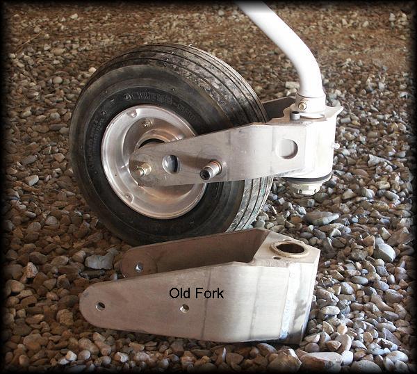

It is shortened from the bottom which increases ground clearance for the
fork but has no impact on prop clearance. Attached pix might help. Not
sure whose it is but it shows the difference well.
Also the $100 from Lang is really $75 for machining and $25 for freight back
and he sends you a check for the diff. I think mine was about $8 back. He
did a perfect job and I had it back in two weeks. A bargain! Building the
box was the hard part.

The hole for the axle and the forward hole for holding the nose wheel
fairing are in the same place. The top of the fork is in the same place.
The bottom angle has changed but is not a factor.
Ron Lee

Ditto what Bill said. The rake diffrence is in the
fork due to the shortening of the leg at the threads.
No clearance difference at all to my knowledge.
