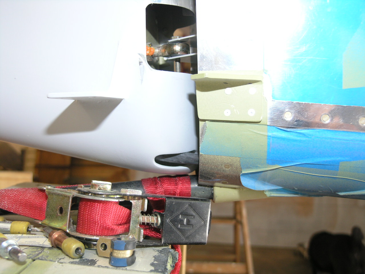

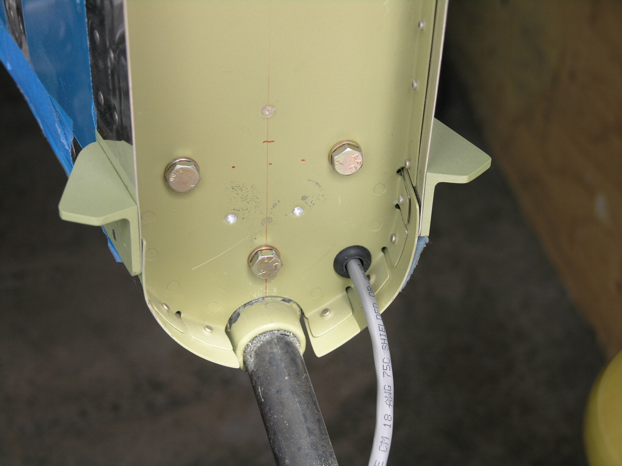

Hello Jim,
Attached are photos of how I accomplished this task -- not the
prettiest, but effective. The slot on the rudder butt allows the wires
to stay put without bending stresses when the rudder is exercised. There
is about 3 layers of heat shrink protection over the wires should
excessive rubbing occur, which I will monitor. In a "static" condition,
there is little if any contact with the wires.
Bill Gill
RV-7 FWF & finishing
Lee's Summit, Missouri

PostPosted: Tue Aug 07, 2007 8:18 pm    Post subject: Rudder wiring? Reply with quote
I was going to put a connector there, until I realized that it would just be
a flex point. I ended up drilling an opening between the tie-down mount and
the bottom hinge and using a grommet. The wire continues down into the
bottom fairing and there's a fair service loop so I can make the attachment
to the Whelen assembly outside the rear of the mount. Once in place,
there's little movement of the wire at the front of the rudder. I still
intend to install some rubber material, left over from the fairings below
the horizontal stabilizer, into the opening in the rudder leading edge. The
idea another person had of using heat-shrink tubing as anti-chafe protection
is excellent; you could also use some of the nylon woven tubing used in
bundling wires and hold it in place with a little heat-shrink. I don't
think the nylon would wear through and it would look very custom.
Patrick Kelley - RV-6A - still waiting on panel
