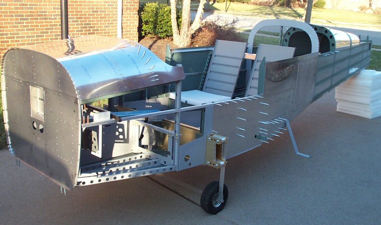

I just moved mine about a month ago. I had made a set of wheels and bolted them to the wing spars. My 16 year old sons and I rolled it onto a 18 foot trailer with 4 foot ramps. I don't have scales but I can pick up the front by myself. The CG in this configuration is somewhere around the front part of the rear seats.
I unloaded it from the trailer by myself at the airport. The wheels were great.
Picture is attached.
These are coming off in the next week or so for the real legs!
Jim C

PostPosted: Wed May 02, 2007 6:49 pm    Post subject: Fuselage weight Reply with quote
<?xml:namespace prefix="v" /><?xml:namespace prefix="o" /><![endif]--> Jim, I want to make something along the same lines. my QB will be here Fri or Sat . do you have a sketch or just deminsions and material used. would appreciate any help. Thanks

jim(at)CombsFive.Com
PostPosted: Wed May 02, 2007 7:17 pm    Post subject: Fuselage weight Reply with quote
I will put something together.
Jim C

Vern(at)teclabsinc.com
PostPosted: Thu May 03, 2007 8:51 am    Post subject: Fuselage weight Reply with quote
Jim,
Thank you for an elegant solution. I was just thinking last night, how
am I going to move this thing around after the tail cone is attached?
What timing:)
Thanks again,
Vern Smith (#324 ready to attach tail cone)
PostPosted: Thu May 03, 2007 5:21 pm    Post subject: Fuselage weight Reply with quote
John,
Attached is a set of instructions.
Someone else may want to build a set.
How about we do this.
You pay the shipping and you can "Use" these. When finished they have to be provided to another -10 builder (Who also pays to have them shipped).
I will have to figure out how to box them up.
Provide me a "ship to" address (Off List!).
Jim Combs
