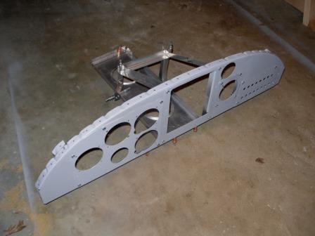

I'm looking for input from other builders on exactly how to build the instrument panel. After the basic layout is determined and holes are cut in the supplied .025 panel, are there 'subpanels' attached to the face of the instrument panel? If so, what are the subpanels made of? Are they best attached using screws and nutplates? What about paint?
If possible, attach pics to any replies (especially of work in progress)!

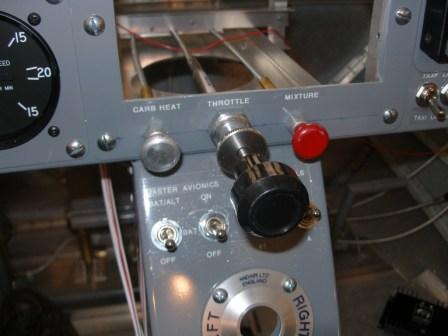

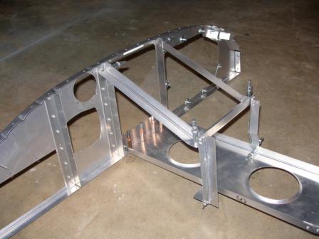

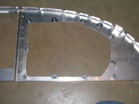

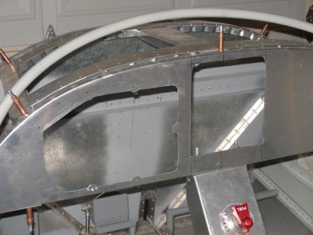

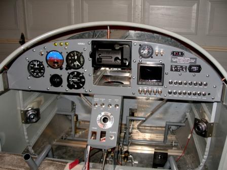

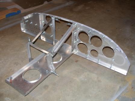

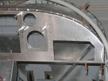

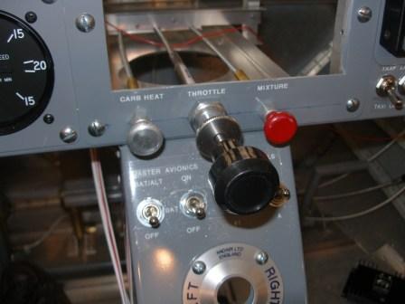

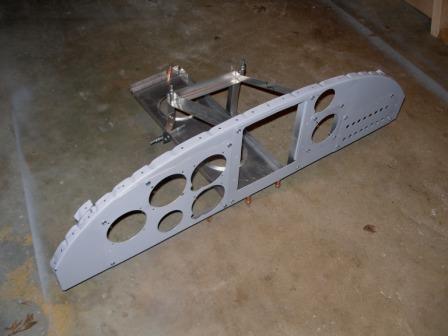

Here's how I did it. As you can see, a lot of the .025 has been cut away. My sub-panels are .040, and they are attached with T-nuts from the aviation department of my local Ace Hardware. I painted it with Rustoleum High Performance Enamel (Home Depot). Feel free to ask more.
Jay in Dallas
