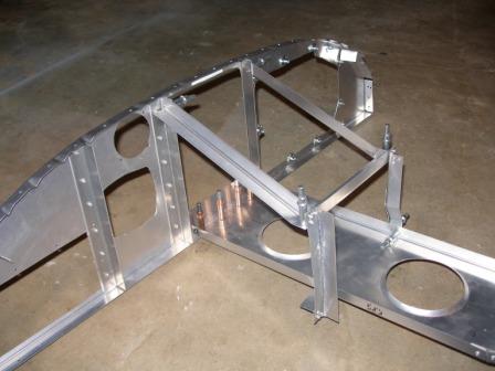

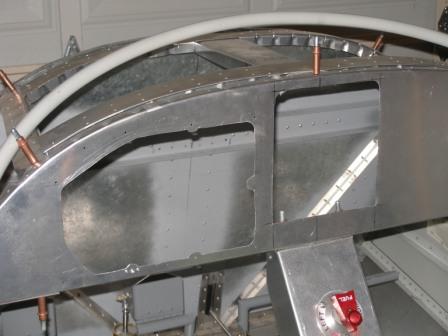

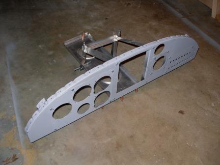

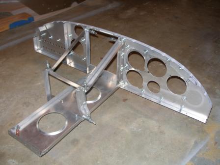

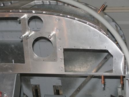

Here's how I did it. As you can see, a lot of the .025 has been cut away. My sub-panels are .040, and they are attached with T-nuts from the aviation department of my local Ace Hardware. I painted it with Rustoleum High Performance Enamel (Home Depot). Feel free to ask more.
