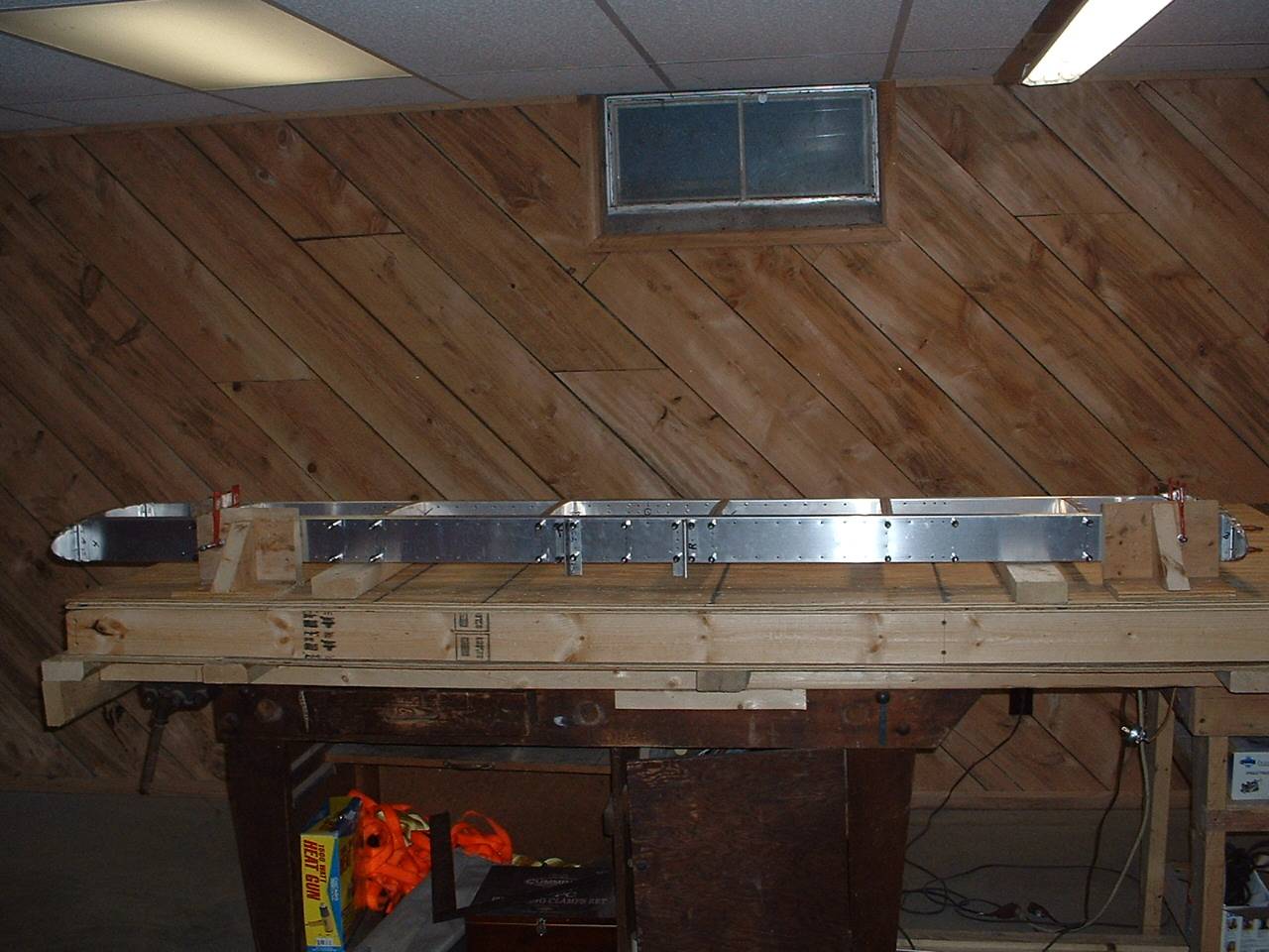

Ron-
Did you have the correct spacers under the skeleton and everything
nailed down before attaching the bottom? You should have your spar clamped
to L blocks to keep everything from moving. Picture attached to give you an
idea of what I'm talking about.

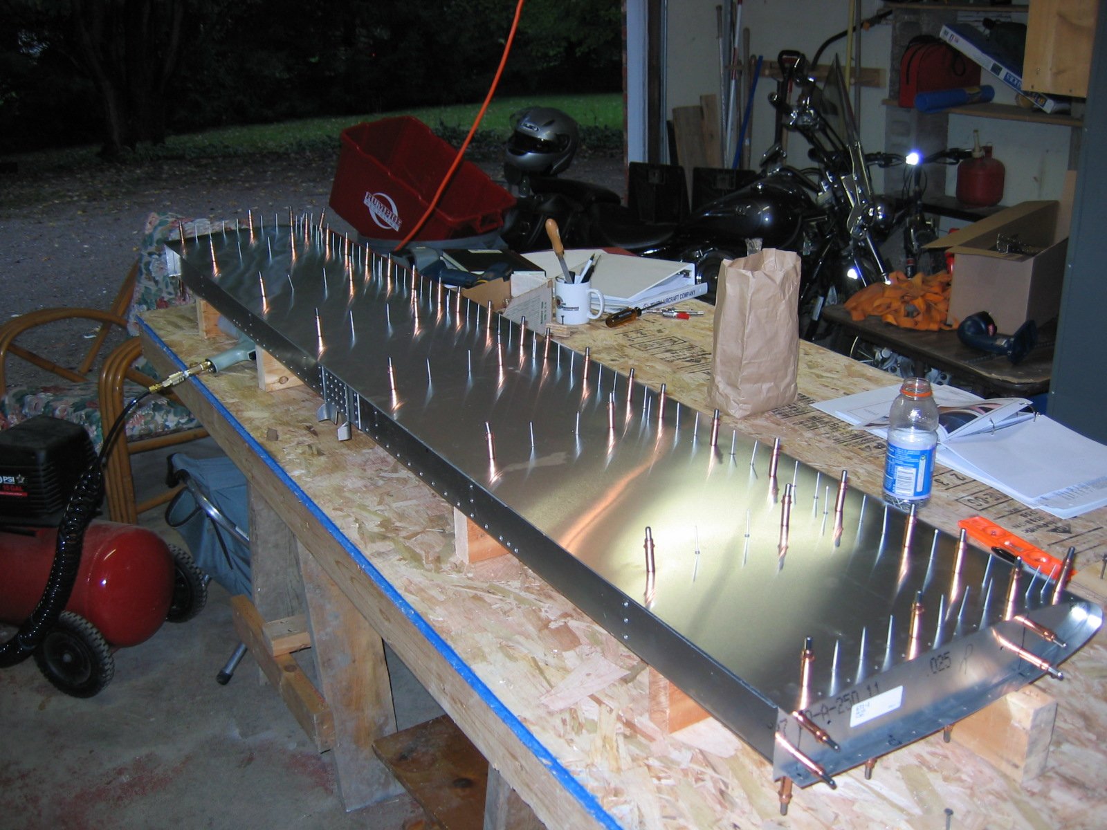

PostPosted: Tue Mar 13, 2007 4:03 am    Post subject: Re: Strapping the Stab Reply with quote
Ron,
I had the pre-drilled skin like you and I remember this going fairly easily. From what I remember, when the line on the front spar flange was visible, the aft edge of the skin also lined up nicely with the rear spar trailing edge. After you get it strapped and everything is level, square and not twisted as referenced in the guides and drawings, go ahead and trial fit the end ribs to get the warm fuzzy that it looks right before drilling.
