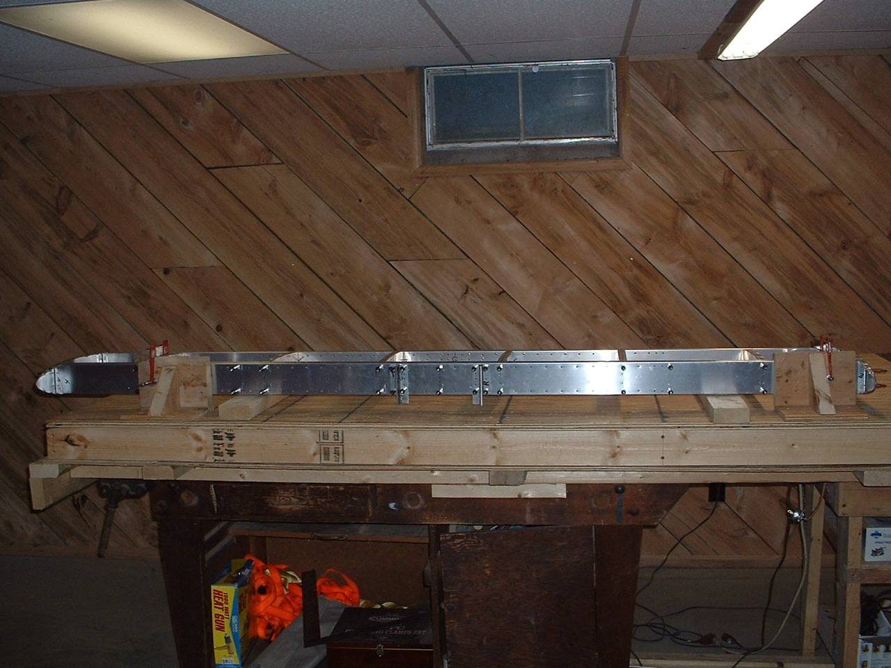

Ron-
Did you have the correct spacers under the skeleton and everything
nailed down before attaching the bottom? You should have your spar clamped
to L blocks to keep everything from moving. Picture attached to give you an
idea of what I'm talking about.
Bill Naumuk
HDS Fuse/Corvair
Townville, Pa

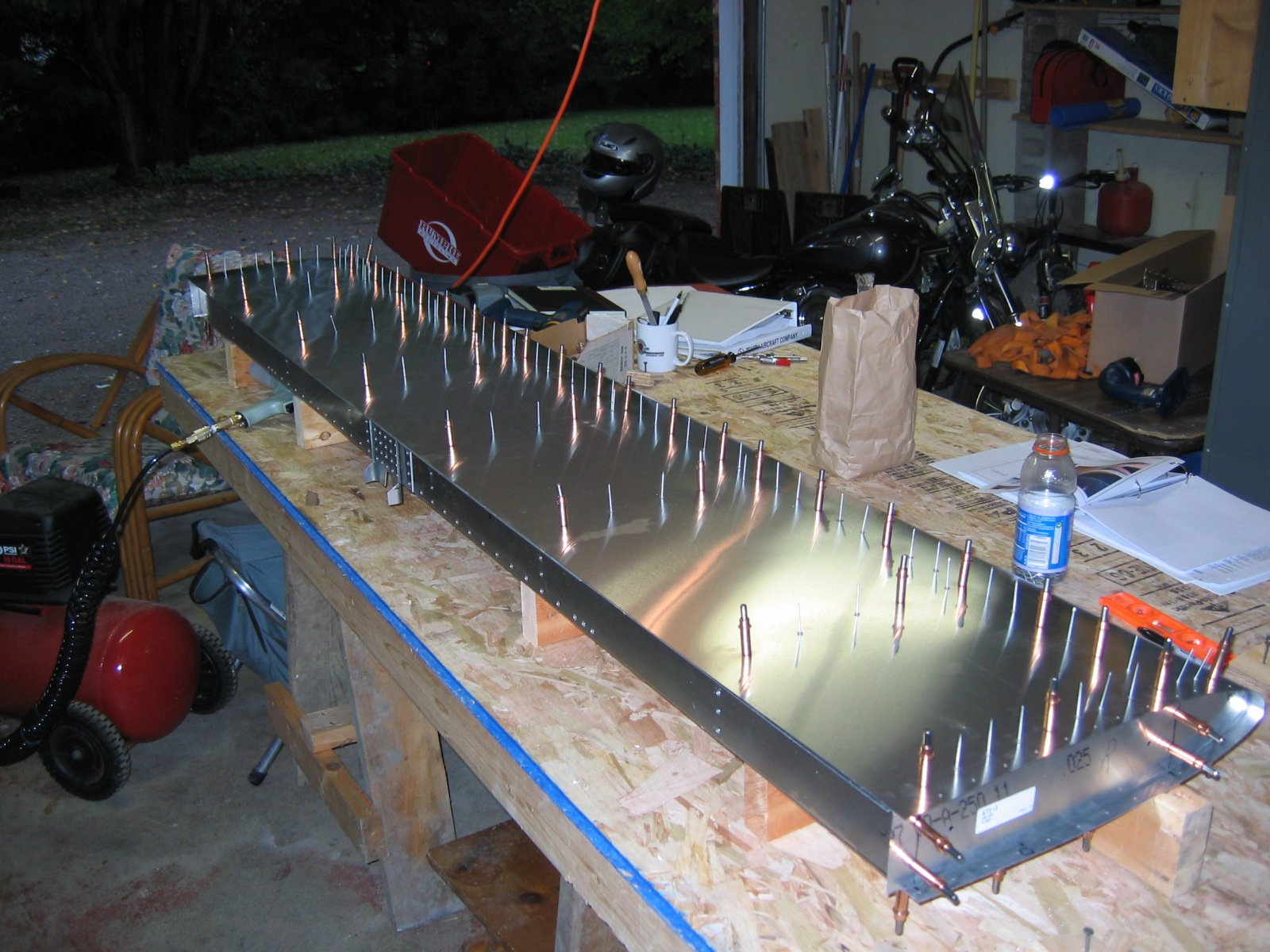

DaveG601XL
Joined: 27 Oct 2006 Posts: 351 Location: Cincinnati, Oh
Posted: Tue Mar 13, 2007 4:03 am Post subject: Re: Strapping the Stab |
Ron,
I had the pre-drilled skin like you and I remember this going fairly easily. From what I remember, when the line on the front spar flange was visible, the aft edge of the skin also lined up nicely with the rear spar trailing edge. After you get it strapped and everything is level, square and not twisted as referenced in the guides and drawings, go ahead and trial fit the end ribs to get the warm fuzzy that it looks right before drilling.
Good luck,
DaveG
