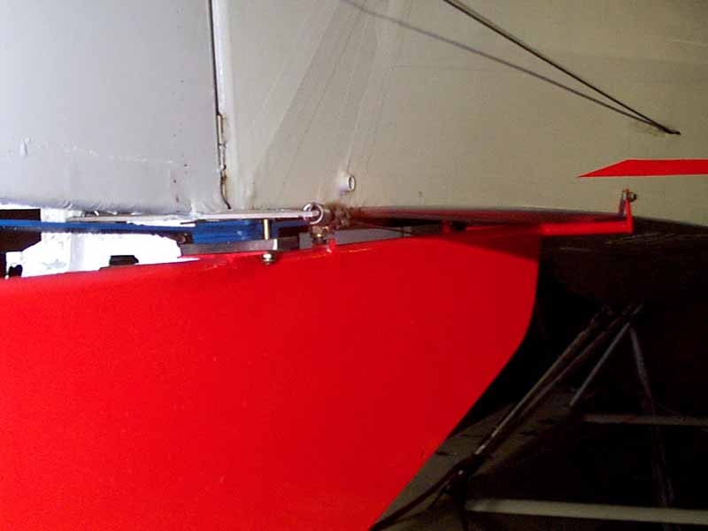

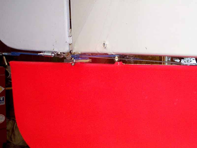

Noel , do you havea ventral fin on your Kitfox while on floats ?
I have flown with and without and find with the fin it flys with less control power needed for rudder pedals.
Without the fin it wass like flying on train tracks with very stiff rudder.

Yes the ventral fin attaches to the front cross through tube and the support for the tail wheel spring. I was able to design a simple stinger to bolt through with it... They say it's not really a floatplane without the stinger. Wink
Noel [quote]
