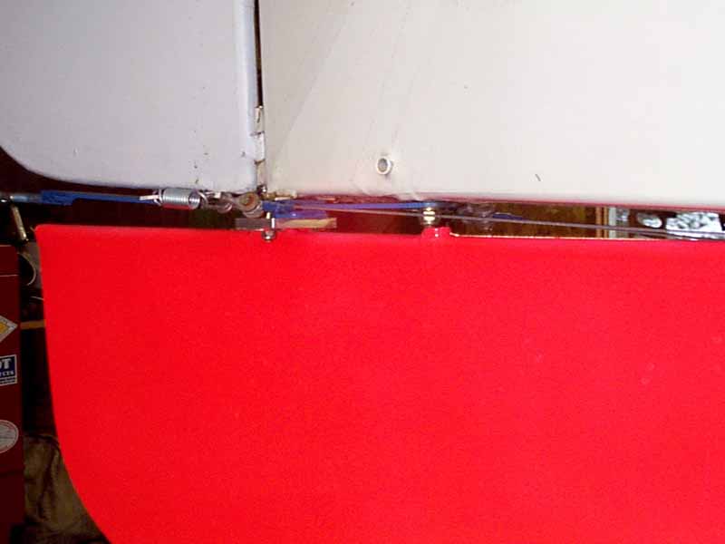

Float Flyr
Joined: 19 Jul 2006 Posts: 2704 Location: Campbellton, Newfoundland
Posted: Fri Jan 05, 2007 12:53 pm Post subject: new kitfox2 great ideas.. |
Yes the ventral fin attaches to the front cross through tube and the support for the tail wheel spring. I was able to design a simple stinger to bolt through with it... They say it's not really a floatplane without the stinger.
Noel [quote]
