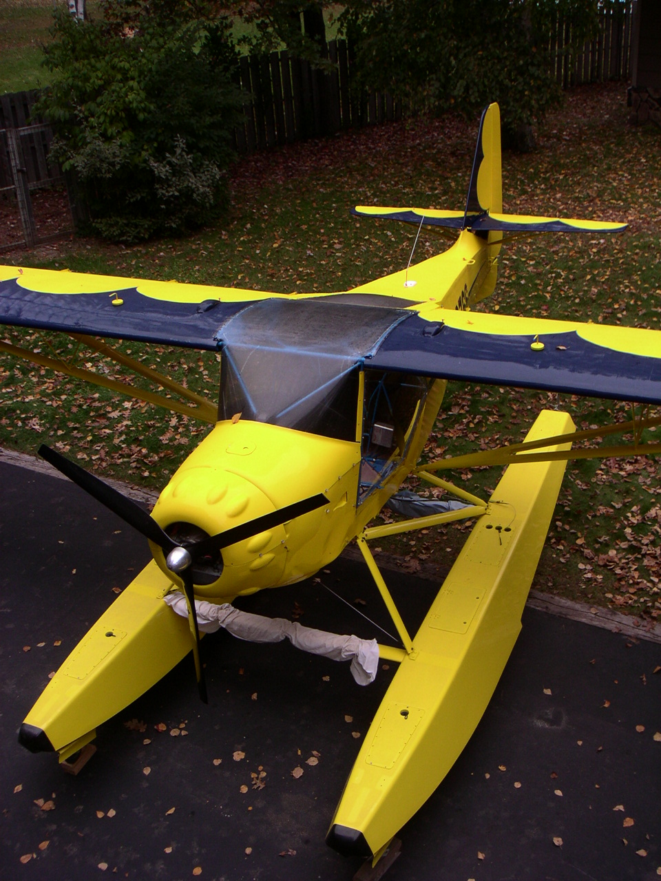

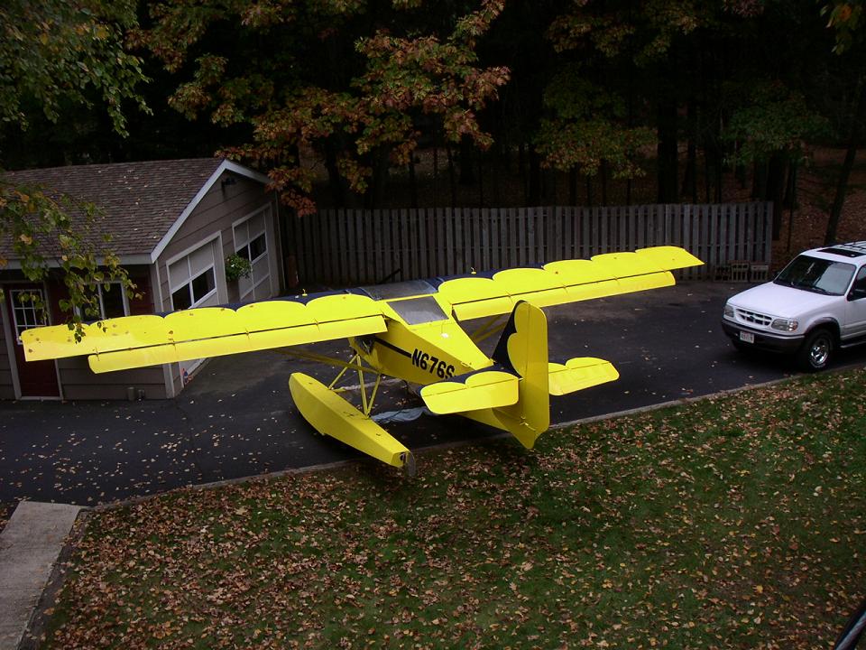

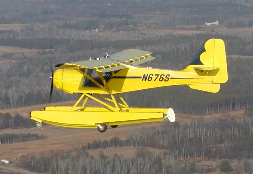

ps - Here's a picture of my plane. Look at all the drag....floats, rigging, water rudder, bubble doors, no radiator scoop, etc., and it will easily go 100 mph even with the wheels down and locked and at gross weight. And I've flown next to enough other aircraft now to know the speeds my gps tests results are accurate (asi isn't). Your Vixen just has to be at least as fast (especially when you start comparing the two aircraft from a logical viewpoint).

What are the Black “bumps” on the top of your wing about on either side of the cockpit?
Randy – inquiring mind,,,,,
Randy
Kitfox 5/7 912S
Black Hills, South Dakota
temco(at)telusplanet.net
PostPosted: Wed Feb 07, 2007 8:49 pm    Post subject: Vixen Information Reply with quote
Randy
Those look like fairings around the gas filler caps.
Ted

av8rps(at)tznet.com
PostPosted: Thu Feb 08, 2007 5:37 am    Post subject: Vixen Information Reply with quote
Randy,
Those are custom fibreglass covers that cover my electronic fuel senders since the sender sits higher than the top surface of the wing. They are also hinged at the front so I can get at the potentiometers that calibrate the senders if needed. Fwiw it works pretty well for fuel levels, but I also use the sight tube as a secondary system for checking fuel level. I've attached two pics that show where they are located on the wing in relationship to the fuel caps.
Ironically, these covers do look like the fuel cap fairings others have used. I haven't installed fuel cap fairings yet, but it's in the works. I had a conversation once with an aerodynamic engineer about those gas cap fairings, and he indicated the reason you should have them is not so much because of the drag of the cap, but the disturbed airflow over that part of the wing is critical and is probably causing a loss of lift. That all made sense to me so it is on my list of projects to do yet.
Maybe my gas cap covers are what make my little float plane so much faster than most other LSA type float planes?? (chuckle)

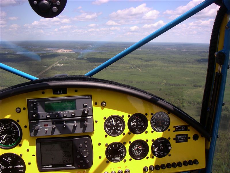

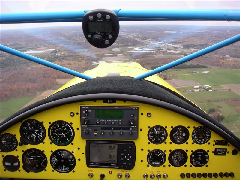

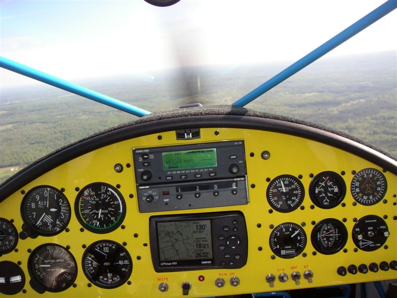

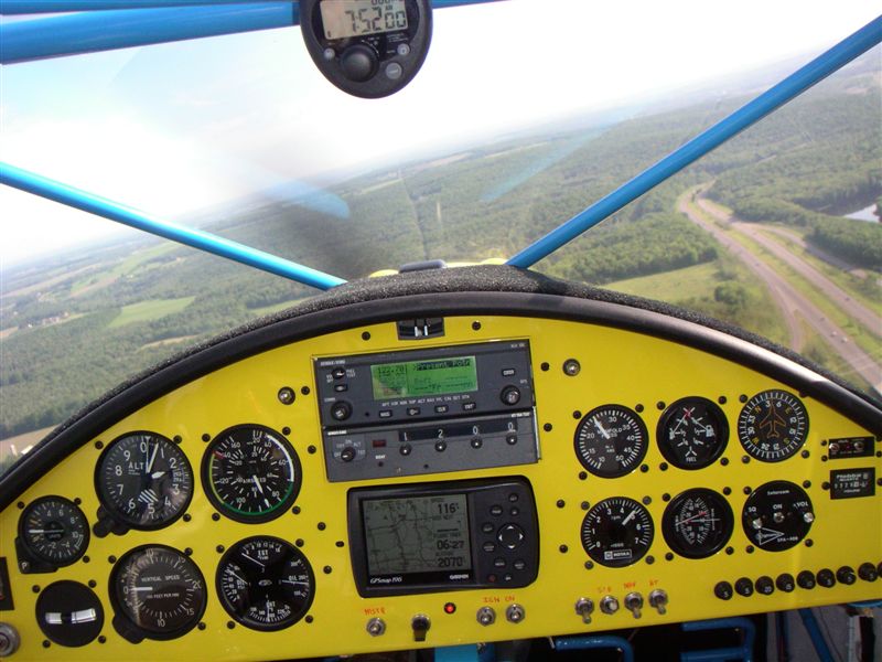

av8rps(at)tznet.com

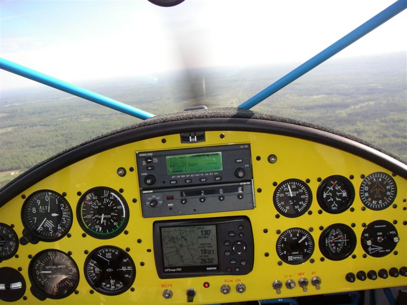

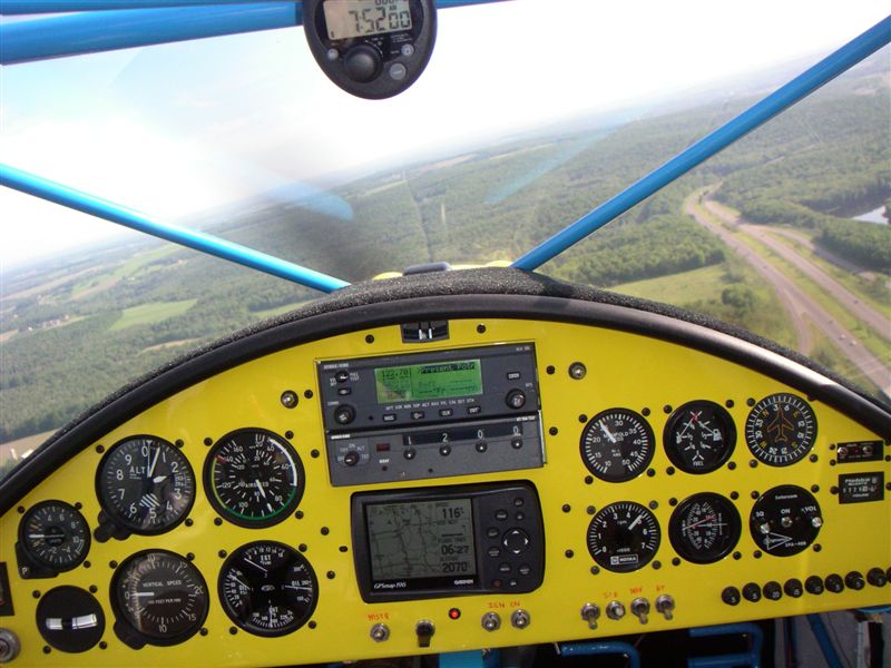

PostPosted: Thu Feb 08, 2007 6:18 am    Post subject: Vixen Information Reply with quote
Bradley,
Very good information. Thank you, thank you! I will definitely be testing
mine per your instructions. That all makes good sense to do.
What's funny is how my readings are not consistent. Here's a few pics that
show what I'm talking about. Check the GPS groundspeed vs the ASI. (HInt;
two of the photos were taken with 15-20 mph tailwinds - just for grins...and
fwiw on the return flight I had a gs of 93 mph avg with a little more
throttle required) With the exception of those two photos the winds were
for the most part calm.
Btw - Yeah, I know my EGT is not operational - bad connector that keeps
coming loose. And my panel labeling is still a work in progress Smile
Paul
