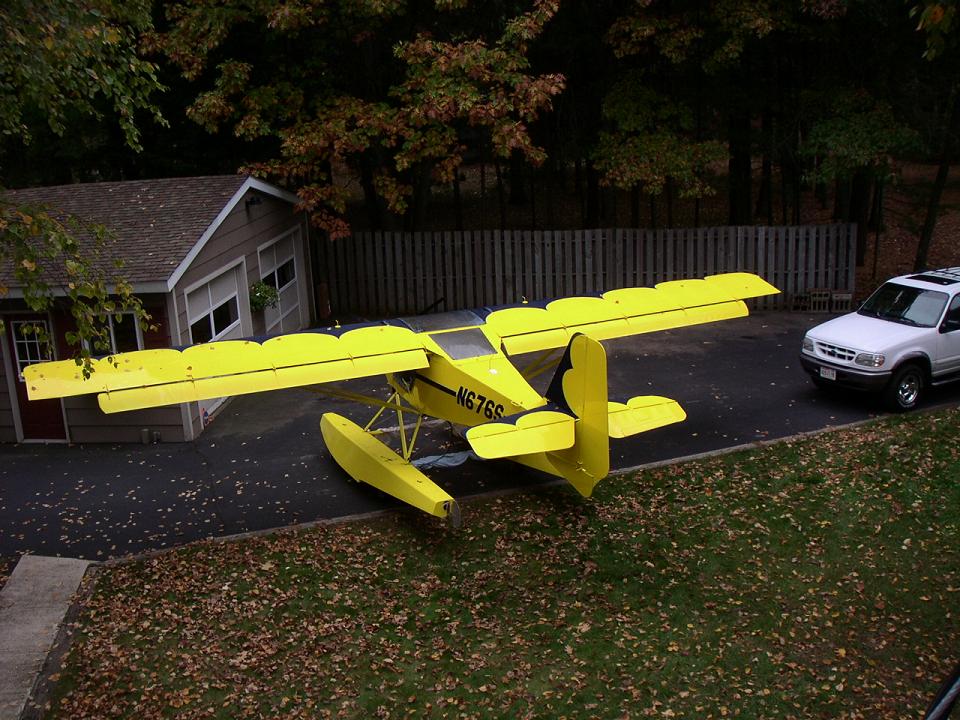

I've noticed that the airspeed indicator for my Model IV is off by sometimes 10 - 15 mph (e.g; reading 85-90 when I'm really going 100 mph). Weird thing is that it is not consistent at all. I haven't played with it much to try and improve it, but I suspect it is because I have one static port located midway down the fuselage on the left side. One day I'll disconnect the static from the instrument and try it that way. It hasn't really bothered me much as I have my Gps in the middel of my panel giving me ground speeds, and that is rarely less than 100 mph. I'm totally happy with that as I'm flying my 912ul Model IV on amphib floats. Incidentally, my Kitfox is the fastest 2 seat light floatplane around this part of the country. It will go 118 mph (tested again and again) flat out wide open on floats. However the asi rarely reads much over a hundred. Drives some of the Rans guys nuts as before my Kitfox came along they were the light floatplanes to try and catch.
I'm willing to bet if you test your vixen further you will find you are flying faster than you think you are. Btw, I think the climb rate is about right, but the stall speed sounds slow to me...once again making me think your ASI is off like mine.
Paul Seehafer
Model IV - 912ul on Aerocet Amphibs
Wisconsin
ps - Here's a picture of my plane. Look at all the drag....floats, rigging, water rudder, bubble doors, no radiator scoop, etc., and it will easily go 100 mph even with the wheels down and locked and at gross weight. And I've flown next to enough other aircraft now to know the speeds my gps tests results are accurate (asi isn't). Your Vixen just has to be at least as fast (especially when you start comparing the two aircraft from a logical viewpoint).

Paul,
What are the Black “bumps” on the top of your wing about on either side of the cockpit?
Randy – inquiring mind,,,,,

temco(at)telusplanet.net Guest
Posted: Wed Feb 07, 2007 8:49 pm Post subject: Vixen Information |
Randy
Those look like fairings around the gas filler caps.
Ted

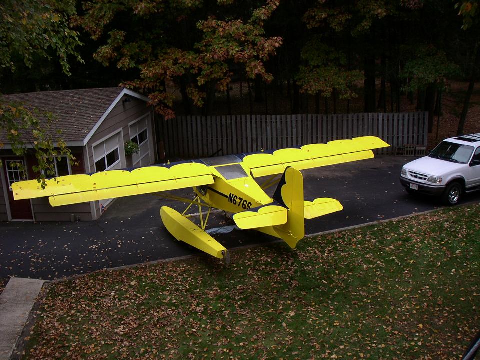

Randy,
Those are custom fibreglass covers that cover my electronic fuel senders since the sender sits higher than the top surface of the wing. They are also hinged at the front so I can get at the potentiometers that calibrate the senders if needed. Fwiw it works pretty well for fuel levels, but I also use the sight tube as a secondary system for checking fuel level. I've attached two pics that show where they are located on the wing in relationship to the fuel caps.
Ironically, these covers do look like the fuel cap fairings others have used. I haven't installed fuel cap fairings yet, but it's in the works. I had a conversation once with an aerodynamic engineer about those gas cap fairings, and he indicated the reason you should have them is not so much because of the drag of the cap, but the disturbed airflow over that part of the wing is critical and is probably causing a loss of lift. That all made sense to me so it is on my list of projects to do yet.
Maybe my gas cap covers are what make my little float plane so much faster than most other LSA type float planes?? (chuckle)
Paul

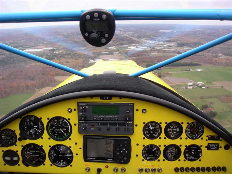

av8rps(at)tznet.com Guest
Posted: Thu Feb 08, 2007 6:18 am Post subject: Vixen Information |
Bradley,
Very good information. Thank you, thank you! I will definitely be testing
mine per your instructions. That all makes good sense to do.
What's funny is how my readings are not consistent. Here's a few pics that
show what I'm talking about. Check the GPS groundspeed vs the ASI. (HInt;
two of the photos were taken with 15-20 mph tailwinds - just for grins...and
fwiw on the return flight I had a gs of 93 mph avg with a little more
throttle required) With the exception of those two photos the winds were
for the most part calm.
Btw - Yeah, I know my EGT is not operational - bad connector that keeps
coming loose. And my panel labeling is still a work in progress
Paul
