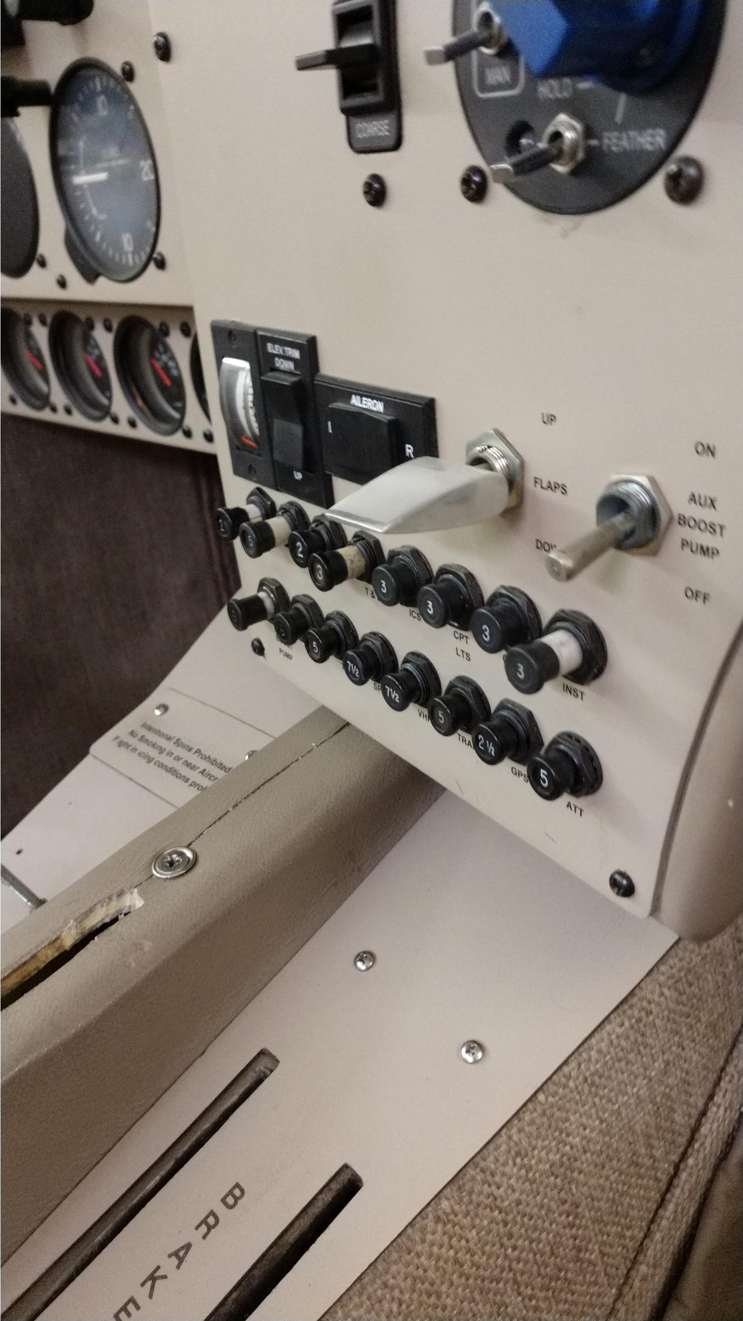

I always offer a ON OFF (ON) for my clients. The flap with limit is s l o w. On a go around just hit the switch and go.
If not on a time budget:. Jerry Hope made a switch mod where he fabbed a flap shape handle, then took apart the switch to prevent the baton from rotating and installed the flap shaped handle to the now non rotating baton.  Gorgeous work.
Otherwise, just a plane switch as described is a few bucks and worth it.  If the PFA allows.

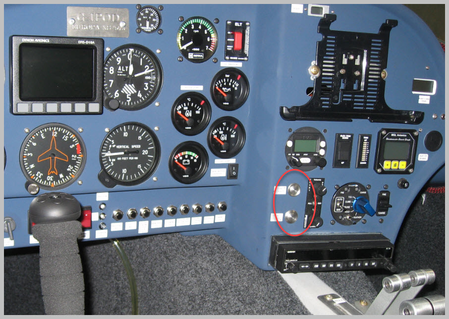

I would really like to change my ‘hold up or down’ flap buttons for a 3 position switch. Retraction or full deployment takes around 12 secs which is way too long to have your hands off the throttle.
Does anybody have information on how to modify the standard arrangement?
John
John Wighton
Europa XS trigear G-IPOD

Bob,
Thanks for the input. I have 2 x 3/4in buttons that operate the flaps, up and down. A 3 position switch will not give me the 3 position control l need (like a C182).
As l see it l would need a position sensor on the flap drive motor to give the mid position signal to stop the motor?
My panel may need a blanking plate and new (ideally flap profile) 3 position switch (see the rather old photo attached).
I have 500+ hours and have so far managed to cope with the buttons, however, an analysis of 'flight blunders' include many that relate to the flap operation as-is. If the improvement could be made without huge drama l will make a mod. But l have seen other Europas with 3 position switches.
JW

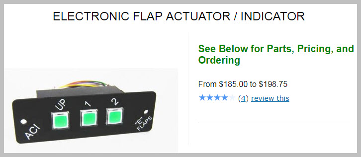

I'm in danger of answering my own questions!
As Bob pointed out Aircraft Spruce stock a range of switches. I found this one https://www.aircraftspruce.com/catalog/elpages/electronicsflapcontroller.php
Which seems to be ideal for my needs. It does not requires a position pot or sensor on the flap drive (no extra wiring). It is calibrated (set) via a combination of push buttons.
It enables 0, mid and full flap positions at a single push. What is even better is the fact it lits up - hence (potentially) being acceptable for LAA IFR fit.
JW
Acknowledgement to Aircraft Spruce for the image.

PostPosted: Mon Jan 21, 2019 6:16 am    Post subject: switch for Flap motor Reply with quote
Hi John,
I think you will still need a position sensor to make it work. See
installations instructions attached.
Brian Davies

No, the device can be set up without position switches. There is an option to include a position switch as seen in the installation manual (which l'd already sent to Andy Draper for comment). The middle position is set up by manually setting it then inputting the button sequence as stated. After set up just push one of the 3 buttons to select the flap required.
Reply to Bob
I don't agree with Bob that most flights need just UP or DOWN flap. I nearly always use MID flap for T/O. We operate from much smaller grass strips where a tangible improvement in field performance is useful. Having flown a bit in the US (about 350 hrs but non in a Europa) most airfields have long, hard runways.
The only slight downside is the size of the unit - it is 4in wide (tall in my case) and may need trimming back.
Reply to Bob

Having flown 500+ hrs in the Europa there hasn't been a single flight when l haven't (mildly) cursed the amount of time holding down that darn flap button!

Thanks - the link in your post is very useful. The sequencer/position device is essentially the same functionality of the one l have found. It is cheaper but does require me to break into the loom for the various connections.
It follows that the unit/installation is approved (via annual Permit renewal inspections or separate MOD approval), so no issues with the LAA either.
Price is USD129, to UK USD148 inc shipping.
