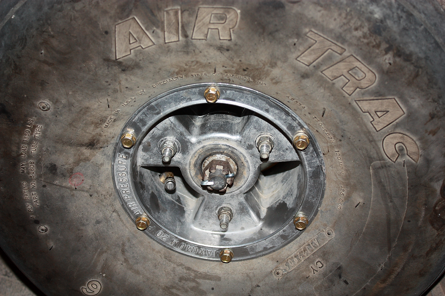

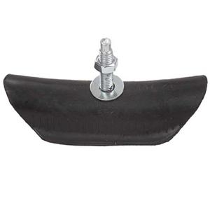

I grew up riding Dirt Bikes and to solve the problem of tires tearing off the valve stem they use Rim Locks. Most Dirt Bikes run about 12-16psi and
a RIM lock device is the most economical way to keep the 55hp motors from shredding the inner tube. I doubt if you can find rim locks for our Kolb sized rims but these can be fabricated easily.

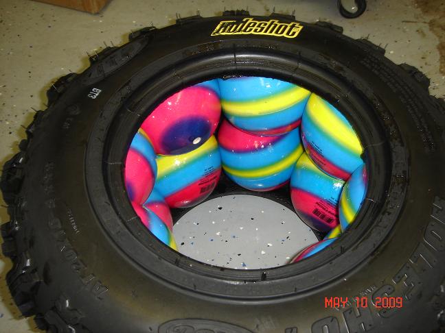

Another solution might be the use of " TIRE BALLS" and no inner tube at all.
They make specific sized balls for almost any sized tire. These are used often in long cross country off road races where the terrain is very rugged. I see guys use tennis balls and all kinds of crazy things that hold up to extreme abuse. A quick search on line and I think you will get many ideas.
Down side is these both add a few pounds to your aircraft.

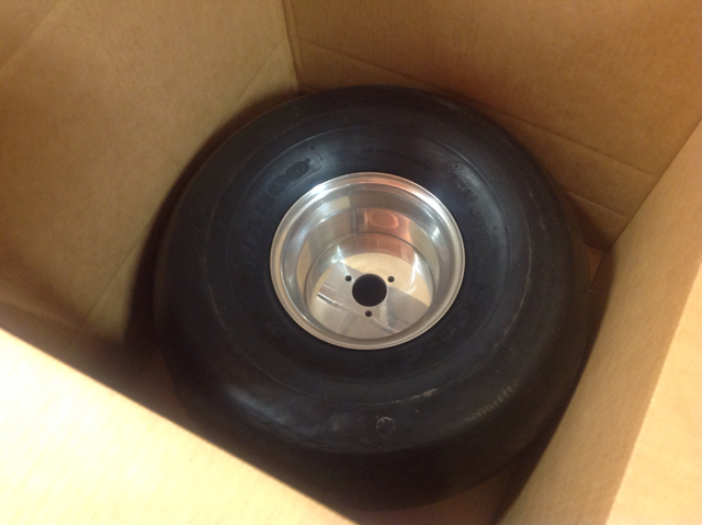

Well I have been selling my tires and wheels that are tubeless for over 7 years, I have never had any returns or complaints and Brian Melbourne has them on his Firestar he told me that since he put tires and wheels that I sell on his Kolb he can Land just about anywhere. Tires and wheels that will fit a black max, Tracy O'Brien, Hegar Brakes systems and more.
http://youtu.be/ysZBXy-pDzI
I have them in stock now

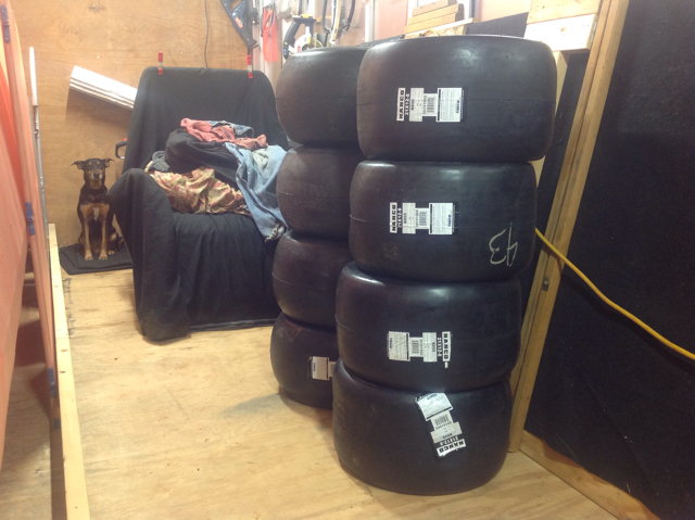

Oh by the way I mount the tires on to the Wheels and they are ready to mount on your plane.they weigh less then factory wheels with the Carlisle turf glides on them.

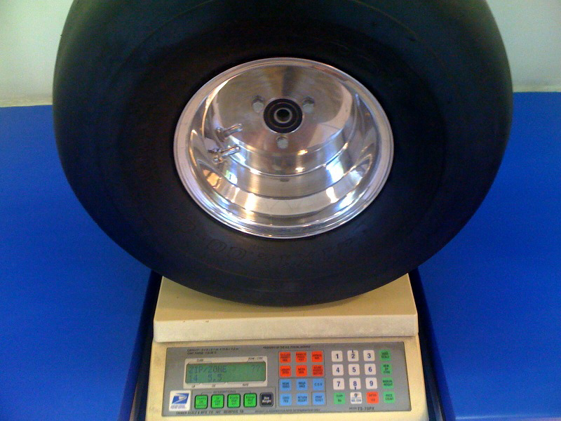

Here you can see the weight and that is with the wheel hub on it... This wheel is 8 inches in diameter and 9 inches wide however most people purchase wheels that are 7 inches wide

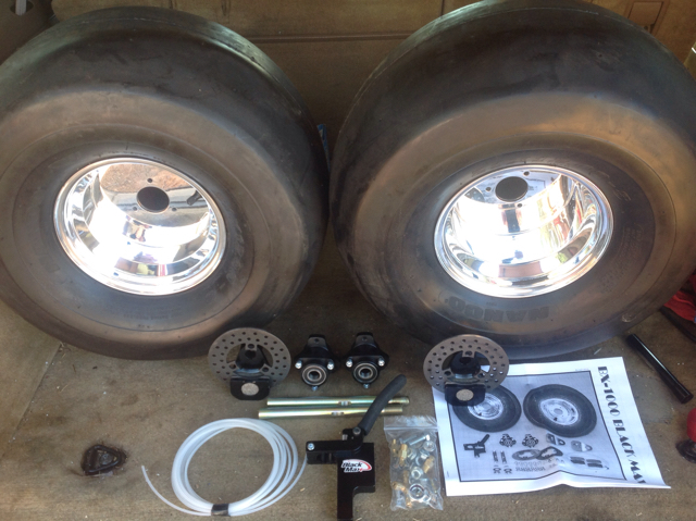

Somebody on the list sent me a PM wanting to know approximate cost and what would they have to do to install these on a Mark III. There's different options for example of whether or not you want hand control stick master cylinder, or do you want differential Heel and Toe Brakes. Also single or dual puck calipers... Sometimes you can use master cylinders from other companies.
Here is a picture of a set up that I sold last month and the customer already had his master cylinders.. Several months ago a Canadian gentleman put some dual puck brakes on a Kitfox and he says it will stop on a dime. He used his own master cylinders

PostPosted: Mon Jan 18, 2016 11:53 am    Post subject: tires Reply with quote
Our bitter weather has moved Eastward, so I got the tires fixed today. I put some washers under these screws just as a precaution in case the screw might be a bit long. I have 6 lbs of air in them. I anticipate that they will be a bit better when landing in our outback, as well as not ripping off the valve stems.Larry
