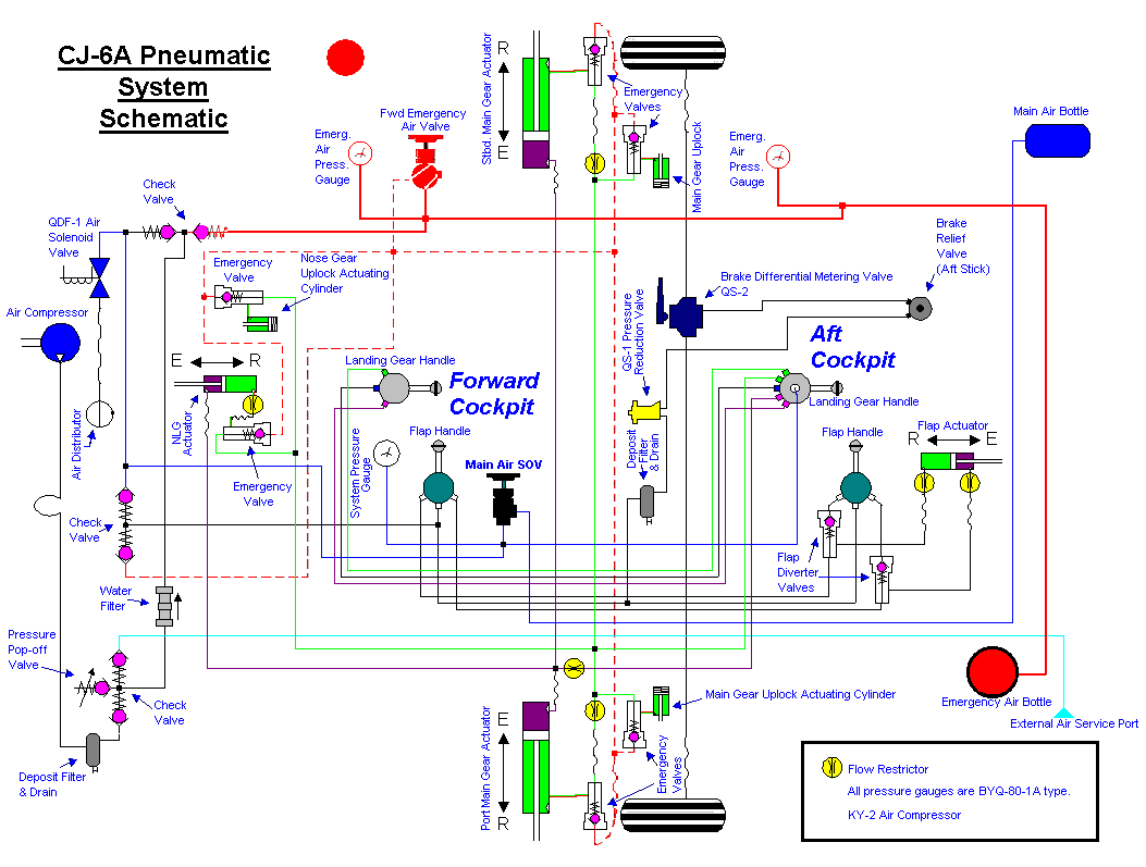

Does anyone have a really good Air Schematic for a CJ that they could forward to me. The one I have is tiny and hard to read. I remember years back someone created a really nice color one, I've searched the archives and see it mentioned but can't find a link to the actual diagram.

Here you go.

See attached. Not sure if it will come through. If not, please email me.

Very nice thanks!

Now I just need something on the diagram interpreted.
I assumed that the flap circuit was similar to the gear circuit, but according this this diagram that Collin sent me the flap valves both have their air provided at the center port. The only difference is the diverter valves on the aft cockpit flap valve (according to the drawing, the diverters I'm assuming are near the actuator).
Am I to interpret this as: Air from the aft flap valve has precedence over air from the forward flap valve at the diverter valves?

You are correct.
