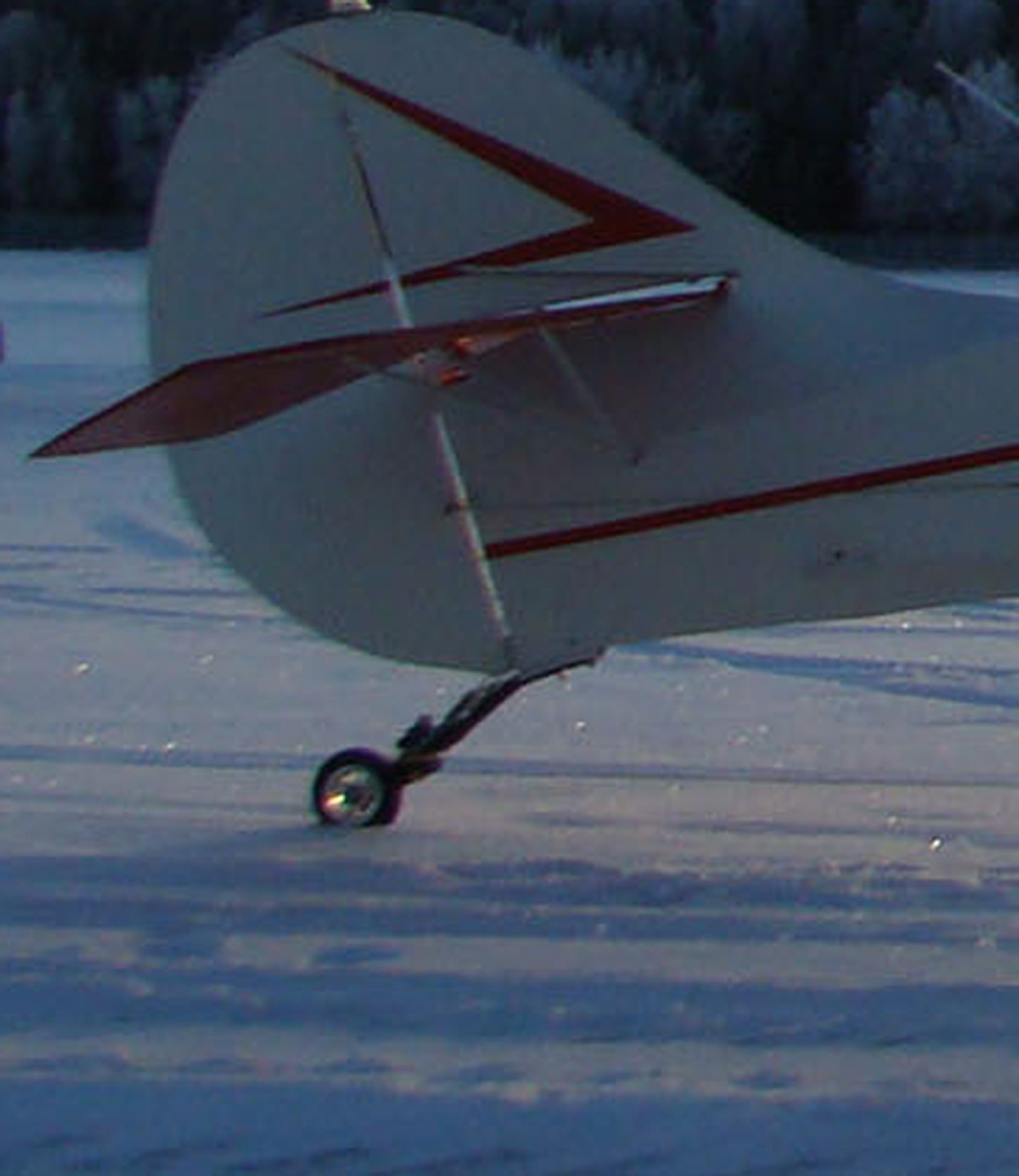

PostPosted: Mon Jan 19, 2009 2:58 pm    Post subject: Re: Tail wheel Reply with quote
Guy Buchanan wrote:
At 09:54 AM 1/18/2009, you wrote:
I are an engineer,
(though I don't play one on TV,)
and I did due diligence via the
Internet. What I found was that, not surprisingly, caster wheel
shimmy, being a resonance phenomenon, does not lend itself to
cookbook answers; there are simply too many variables involved.
Oh, and I also found this: http://www.pierceaero.net/tws.php.
Guy Buchanan
San Diego, CA
Did you at least stay at a holiday in express last night :dunno: If not we are gonna have to lump your opinion in with the other chumps LOL. Sorry, I let the humor outa the bag again, I need to tie a tighter knot in the top of it.
My tail wheel is the Matco Pneumatic and with the 2 leaf spring (gasp, I hope is does not fall off) as luck would have it it is pretty much straight up and down on the pivot point, maybe leaning slightly aft. No issues with shimmy, but I take off full stick forward and get the tail up in just a few feet so I don't have anything digging into the turf. Landings are normally 3 pointers but I have not had any shimmy issues yet. I run the compression springs pretty darn tight and that may have alot to do with it too.

My conjecture during assembly was that the "forward"
configuration minimized shimmy. Did I do any math? No. But here's
my educated opinion: Shimmy is a resonance condition requiring mass
for inertia, plus a restoring force for amplification. To amplify
shimmy that restoring force wants to act at a time and in such a
way to "amplify" the response. We have two cases to investigate:
1. Pivot "forward": (As above.) At rest, if the tailwheel turns the
tail drops and the tailwheel wants to continue to turn up until it
has turned 180 degrees. In motion, if the tailwheel turns, the
moment offset between the contact patch and the pivot causes the
wheel to want to return to centerline. The "tail drop" caused by
the "forward" pivot tends to reduce this restorative force.
2. Pivot "aft" per http://www.bowersflybaby.com/tech/
Maule_Tailwheel.pdf, page 17: At rest, if the tailwheel turns the
tail lifts and the tailwheel wants to return to centerline. In
motion the response is the same as in 1, above. The "tail lift"
caused by the "aft" pivot tends to add to the restorative force.
I won't address the case of the pivot being vertical,
because that's nearly impossible to achieve. Now in case 2 there is
more restorative force than case 1. I therefore speculated that
because the shimmy was driven by the restorative force I'd have
less likelihood of shimmy if I had a "forward" pivot.
That was my logic and it left me, for whatever reason, with
no shimmy. Now as you have probably guessed, I are an engineer,
(though I don't play one on TV,) and I did due diligence via the
Guy Buchanan
San Diego, CA

That is a pretty good story and writeup. He also has posted his arbitrary definition
with a drawing of what he uses as positive and negative caster angle.
<http://www.pierceaero.net/techdata/tws.jpg>
I see that the amount of caster offset apparently offers greater shimmy resistance
which more than compensates for the loss by the tail lifting force produced by the
posiitive angle. This is confirmed by testing and corroborates Lynn's experience.
A small positive angle (like Lynn's) seems to be the ticket to success along with good
maintenance, lubrication, and if using a pneumatic tire, high enough pressure to keep
the tire from slipping on the rim in spin up. A positive angle also makes it easier to
induce a turn. Too much and it will spin around backwards.
It would appear to me that 15 to 20 degrees of negative king pin angle is likely to
produce shimmy.
I have mine set at very close to vertical. If I have shimmy problems, I'll give it a
wee bit of positive tilt by shimming the tail spring.
This has been great with so many people providing experience input. Lynn, Deke, Guy,
Lowell, Noel, Len and Gary have all contributed to this knowledge base.
