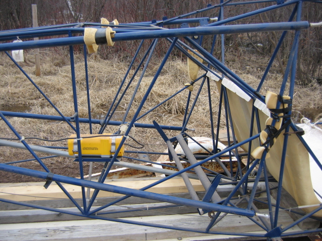

One of my flaperons goes further than the other, and I can guarantee you that mine are rigged according to the book....Model IV.  I can't see how they could possibly move the same when the bellcrank is set to 26° on one side and 32° on the other (as I recall the numbers).
If you set the bellcrank "level", that might be the problem, because as I recall it, aren't the flap control arms set to different angles? Maybe the Model 3 is different....

PostPosted: Sat Dec 05, 2009 3:01 pm    Post subject: kitfox 3 Reply with quote
I don't think that lengthening the pushrod will correct the 10°
difference between the flaps/ailerons. That difference (to me) points
to an error in setting the flaperons up initially. With the Model 4,
they have you build two devices that clamp around the flaps, and
establishes the neutral position, then the linkages are connected,
and so each flap *starts* at a neutral setting. Further "upstream" of
the flaps...that is, closer to the stick, and the stick itself is
further neutralized, and the angles of the bellcrank arms are set to
whatever angle the manual suggests.
Unless the Model 3 is WAY unlike the 4, the rigging should start with
setting the fuselage to level...side-to-side, and fore-and-aft...then
setting the stick to plumb (at least side-to-side plumb). I would
think that this initial setting should be the same for both models,
and then Lord knows where it goes from there, but I would also think
that a neutral flap should also be part of the rigging.

On Dec 5, 2009, at 5:29 PM, Patrick Reilly wrote:
Lynn, Thanks for input. Jim Chuk says the mod 3 & 4 flapperon
linkage are totally different. I thought I had heard that
somewhere. My builders manual is at the hangar. I will look at it
again, but I swear it didn't give detailed instructions as to
rigging the flapperons. Mine was assembled when I got it except for
the pushrod under the seats that I shortened by a 1/2". I'll have
to pull the seat out and figure out what the hell is wrong. I bet
if I lenghten that pushrod everything will line up.
Pat Reilly
Mod 3 582 Rebuild
Rockford, IL
Lynn

thesupe(at)hotmail.com
PostPosted: Sat Dec 05, 2009 4:46 pm    Post subject: kitfox 3 Reply with quote
Hi Lynn and Pat.  I have a few pics of the mixers one a 3 and 4.  The blue is the 4 C the other is a bit hard to see C but I'm sure Pat will recognize it as looking like his.  The picture of the 4 is when I had it on the trailer bringing it home C and the 3 project is when I was putting it on ebay.  It had been in a trailering accident  (wing came loose and unfolded and hit a sign) before I bought it C and I never did a whole lot with it other than rob parts off it (like the engine) for my first Avid.  Take care C  Jim Chuk  Avids C Kitfox 4  Mn

Pat Reilly
Joined: 06 Aug 2009
Posts: 345
PostPosted: Sat Dec 05, 2009 6:17 pm    Post subject: kitfox 3 Reply with quote
Jim, Thanks. Yes the yellow one is like mine.The 4 model is totally different design.

Pat, I looked through my manual and I do have some info on flaperon rigging on page cf-18 it shows (flaperon neutral position rigging details) this page doesn't say which model it is but the figure looks like a model 3 wing and then on page cf-n-1 it has flaperon rigging instructions but its says model 4 on that page so this probably won't help you,my manual has different model numbers throughout the book not sure why this is.

PostPosted: Sun Dec 06, 2009 4:13 am    Post subject: Re: kitfox 3 Reply with quote
Pat the tube that runs under your seat will only chenge stick position Left to right. You will get less travel one way now possibly.
I think the Model 3 mixer is the same as the model 2 unless it has been retrofitted to the mod 4 upgrade. If you you will have aileron differential.
Take some pics of what you got .
I have the model 2 and 4 manual her if you need them scanned or likely Mc Bean does as well.

PostPosted: Sun Dec 06, 2009 10:21 am    Post subject: kitfox 3 Reply with quote
Dave, Thanks for info. My linkage is definetly model 3. I will dig into it next week.
