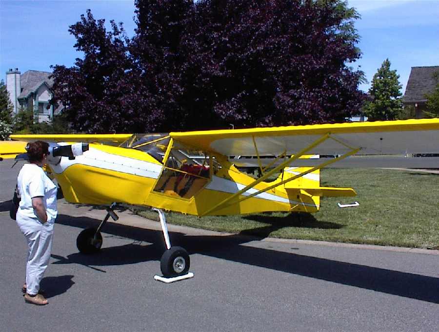

PostPosted: Sun Mar 08, 2009 3:54 pm    Post subject: gear weight Reply with quote
Deke,
I believe your gear is Grove. I recall a friend that had the taller thinner
gear and it was grove, I think it was an early version. I found a picture
of his airplane, (attached) and it was powered, incidentally, by a Franklin
engine. He lives in Marin County, norht of San Francisco.
Lowell
 Filesize:  67.26 KB
 Viewed:  4570 Time(s)
lcfitt(at)sbcglobal.net
