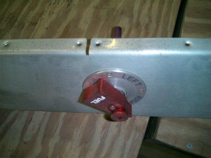

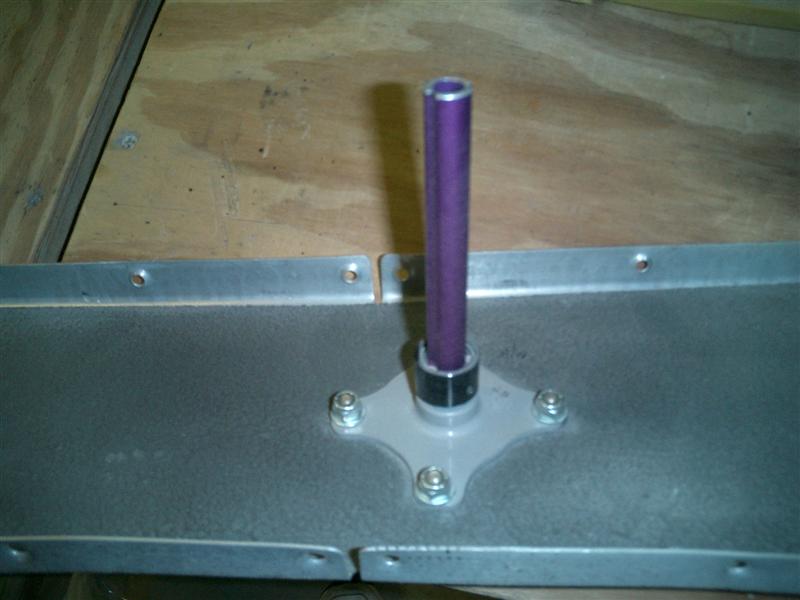

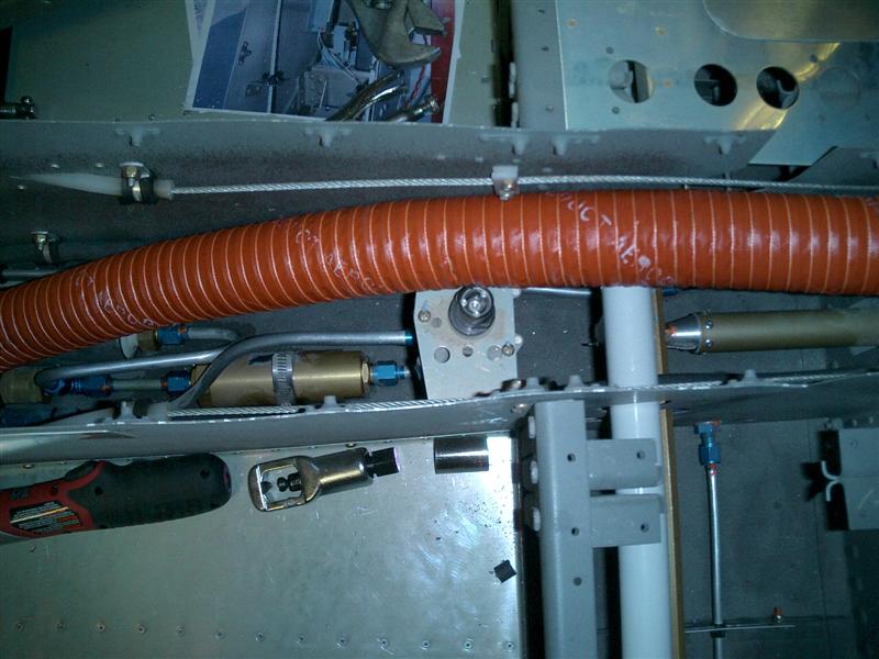

BTW if anyone is interested in what you can do with the Andair valve and extension, here is a picture. I just set the scat tube in to take a picture but you can see that it clears the valve no problem. I secured the faceplate and valve handle with extension to the tunnel cover. When it's in place and screwed down the tunnel cover will not let the extension disengage from the valve.
Michael
