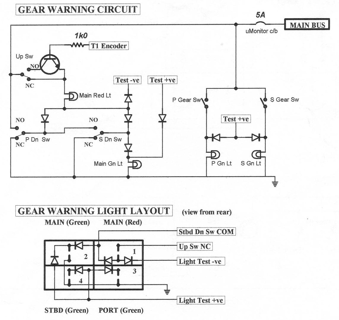

I didn’t bother with a red light for the outriggers but by using a
pair of microswitches for the main gear I have arranged it so that
there are 3 greens when the gear is down, one red when unlocked and no
lights with the gear up.
>Are we talking about LEDs, or some kind of bulb?<
Either will be fine but as higher power LED’s are now available these
make an obvious choice as they use less power and last longer. I have
also fitted a lights test button to test all my warning lights but this
adds complication because a diode is required for the test feed power
for each warning light.
- Any chance of a photo of an installed system?<
I am abroad at the moment. The photos if I took them would show a
block of 4 labelled rectangular warning lights (3 green, 1 red) on the
instrument panel just to the right of the gear lever in the up position
and a microswitch mounted to the OR4 positioned so its lever arm is
depressed by the OR7B when the outrigger is latched down,
Like I said in my original post, my being electrically-challenged, I
plead for information spelled out in crayon,<
If it is of help there is a copy of my wiring diagram attached to this
email. Ignore the transistor part of the circuit. That is a gear
position sense feed for the uEncoder.
Nigel

fklein(at)orcasonline.com
PostPosted: Tue Jul 22, 2008 8:39 am    Post subject: Unlatched outrigger Reply with quote
Nigel,
Thank you so much for the detailed information and concise answers to
my questions. To the untutored like myself, your circuit diagram is not
exactly "in crayon" but I'm sure I can find a local pal to translate
for me, and it is afterall, just another opportunity for me to learn
something!
Cheers,
Fred
