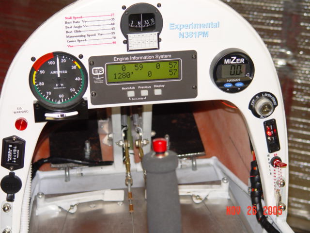

Posted: Thu Jan 25, 2007 4:00 pm Post subject: Re: Airspeed Indicator Markings |
Hi Mike,
I bought my arc's at ??? ACS&S or LEAF....
One thing to remember , If you look at the picture that I attached...
The Airworthiness Inspection requires the glass to be taped to the outer
ring.....Notice my Red Vne.....it overlaps.
Gotta Fly...
Mike & "Jaz" in MN

JetPilot
Joined: 10 Jan 2006 Posts: 1246
Posted: Thu Jan 25, 2007 5:35 pm Post subject: Re: Airspeed Indicator Markings |
Hi Mike,
That is the same ASI that I have ! Same ESI also. What is LEAF and also, where did you get the transparent decals with the lettering that give your V-Speeds and that says ESI warning ?

planecrazzzy Guest
Posted: Thu Jan 25, 2007 6:36 pm Post subject: Re: Airspeed Indicator Markings |
Hey Mike,
I'm a "Cheap" SOB....Those were typed on the computer, Then printed out....cut out....and "Taped"
( By the way , I changed those "V - Speeds" , I had some wrong )
That's another thing that they want for the Airworthiness inspection....
EVERYTHING LABELED....So until you get it the way you want it...
A quick solution is to type it , print it , Tape it...
Do you have the VSI in your EIS ? .....( I Love mine )
Well, it's Not LEAF...... it's L.E.A.F. I think there in Wiscosin....
I bought my Engine and prop from them...
Here's there address :
http://www.leadingedge-airfoils.com/
They have a catolog too , it's not as big as ACS&S
Gotta Fly...
Mike in MN

planecrazzzy Guest
Posted: Sat Jan 27, 2007 6:54 am Post subject: Re: Airspeed Indicator Markings |
Hey Mike,
If you notice , the important numbers are in RED....Stall & Vne
One of these days , I'm gonna have an Engraving Shop carve me one out of Plastic ( two tone) like name tags....Then I'll use a red Sharpie to
make the Stall & Vne in red....
Same with the other side where I have "Experimental N381PM"
it'll probly be cheap enough to replace them all with plastic ones...
After you find out "YOUR" stall speed , That book tells you how to figure
out the other "V speeds".....at least "ballpark"
The book is also handy for flight testing your plane....it gives pretty good
suggestions for flight plans....especially that first flight.
One thing the FAA guy wanted , that the book didn'y mention....
He wanted the CG in the "Front half" of the CG Range....
I had to drain my rear fuel tank ( re-plumb ) and also put 16 lbs in
the nose of the aircraft to get it .
Gotta Fly...
Mike & "Jaz" in MN
