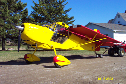

Building a one time mold isn't expensive if you just use typical one inch blue board foam then cover it with glass. When it's set up remove the foam and you have a scoop. It almost requires the airplane be upside down though, but when the wings and engine are removed it isn't too difficult with Somme help.
I'm going to attach a photo of mine. It's on Sportflight, but the site is down temporarily so I can't send a link. I'll try an attachment.
Deke

I have the scoop offered in the Model IV Speedster kit. I picked it up from
a builder in Alaska that didn't want to use it. Others have gone the hard
way and built their own. I don't think the Speedster scoup is still
available. Contact John to make sure of that.
Regarding winter flying, the scoop actually enhances cooling.
Lowell
