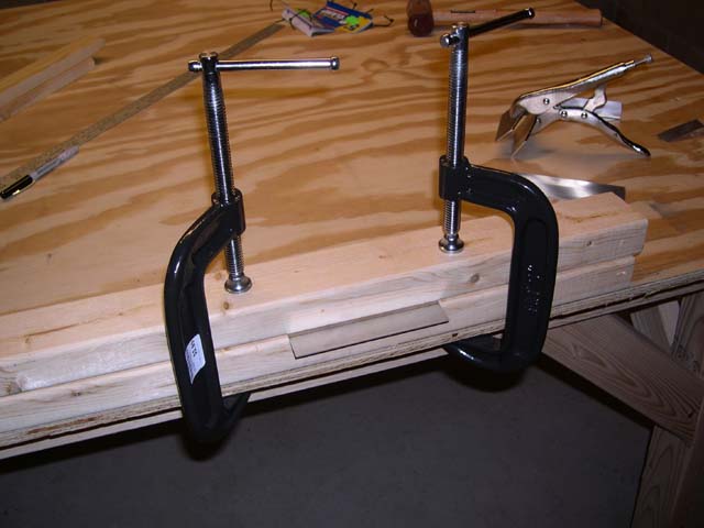

I agree; change them now to .063. I made my own, and I didn't even need to use a break. I sandwiched the piece between two short 2x4's, and bent it over with a rubber mallet. The radius on the 2x4 was perfect, and I only needed to bend it slightly more after taking it out. Very fast learning curve also; I only made one bad one.
