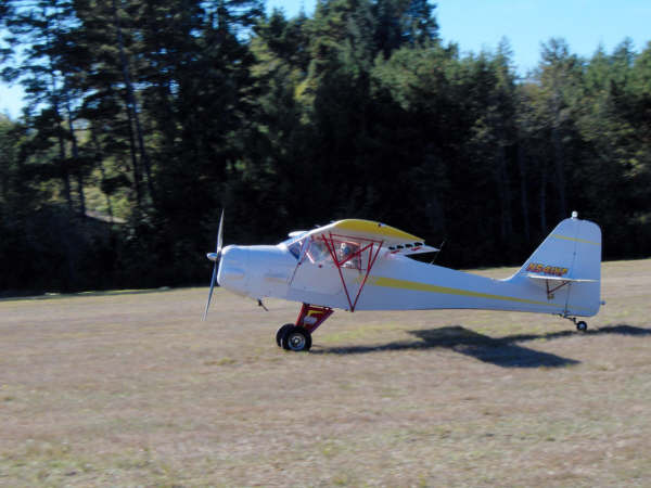

roncarolnikko(at)hotmail. Guest
Posted: Fri Dec 01, 2006 5:49 pm Post subject: Beacon? Strobe? |
Deke I'll post an after picture. The funnel sits pointing downward as if in
use. the flat top is where the base of the light attaches. The spout and
part of the sides get cut off to form a channel which drops over the
vertical stab. Place plastic barrier over stab, then place funnel over,
then fill with epoxy. Remove, sand paint, walla. Sorry I don't have a
close up, but it flares to a flat spot like a Cessna. Ron NB Ore

Fox5flyer Guest
Posted: Sat Dec 02, 2006 4:18 am Post subject: Beacon? Strobe? |
Thanks Ron. I understand now.
