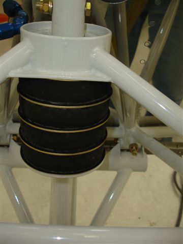

I went to installed the nose gear today. In particular, the link collar assembly. Vans states, "The nose gear Elastomers will have to be compressed in order to install the bolt. Do this by either pushing down on the forward end on the aircraft (yeah... right!) and/or lifting up on the aft end."
YGTBSM! Can you imagine pivoting the fuselage on the nose gear by pulling up on the tail end? That's just plain stupid and unsafe! I tried pulling down on the front and hardly moved the thing.
Below is a pic of what I did. Works great and much safer! Hope this helps someone when they get to this stage of construction.
Zack

This way of compressing the Elastomers is a piece of cake. It really is. I didn't research it in the archives. I was in the shop assembling this thing and didn't like the way Van was recommending.
The bolt went through easily. No problem. I ractheted the come-a-long tight but wasn't extremely tight. I did it all by myself with no help at all. It works.

You really don't need to modify this techique. As you can see from the photos, I tried to use max leverage. The strap is wrapped around the forward part of the nose gear. The strap wraps around the 2 top engine mounts. This gives max leverage.
As I started cranking down on the strap, I watched for any deformation of the mount or gear. NOTHING! Gus Funnel told me on the phone that the motor mount not only has to support the weight of the big six cylinder under normal conditions, but also has to do it with 6 g's on it! Nuf said.
Zack

OK. You could probably jack the tail up, but not by yourself. After the mains start to leave the ground (and they will because you will not get enough compression), the fuselage becomes very unsteady and wants to roll. If you had more people to watch and steady the fuselage, go for it. It still takes alot of force to compress the elastomers. The full weight of the aircraft is not there yet, i.e., wings, tail, engine, etc...
Zack
