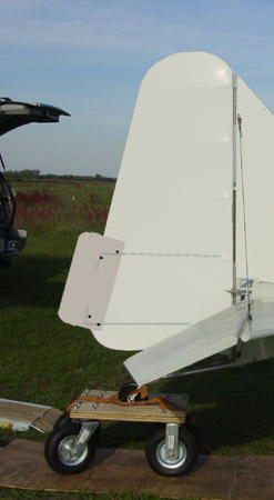

The huge rudder trim tab (12" tall and 6 3/4" wide at bottom, bent about 15 or so degrees to right as you face the cockpit, and riveted 22" down from top on the trailing edge pipe of the rudder)
<<<SNIP>>> |
Not sure from whom/where I got the recommendation for attaching the fixed trim tab, (CRS) but I do remember that it was from a respected source.
Mine spans the bottom two ribs in the rudder (not the bottom edge). This puts the vertical center of the trim tab at about the horiz stab. In the construction of the rudder, the ribs are bent at the rudder trailing edge into 'L' shape, then riveted to the TE. The rudder trim tab was made of sufficient size to be able to rivet it to the ribs a couple of inches forward of the TE and in the 'L' where it connects to the TE. I did not rivet it to the TE. Have attached a picture of the rudder showing the approximate set up for the trim tab and where it is riveted. The blue lines are the rudder ribs and the dots show the rivets. (The picture was actually taken before the trim tab was installed. I have modified the image to show the approximate setup.)
| jsflan(at)valornet.com wrote: | A&P said it you are having to hold right rudder, you are already fighting that trim tab..
<<<SNIP>>>
Would agree with your A&P re: fighting the rudder. Too much trim. Take some of the angle out.

If you do not have strong return springs on your pedals then you can expect the rudder to flutter if you remove your feet. In my case, there are no springs, instead there is a return cable loop. It works well but if you take your feet off the pedals you can expect a flutter to start soon.
Also, when Bryan Melborn builds Fireflys he always puts the same tab on the rudder from the get go. According to him it works every time. When he recovered my Firefly he puts his standard tab on the rudder and it work perfectly.

That is why my MKIII has a counterbalance on the rudder as well as on the ailerons. Not just a slight flutter, more like "Your boom tube is now a sine wave" and the rudder pedals are moving to the stops in both directions flutter. Some rudder flutter is fairly common for Kolbs, but mine was absurd. And probably very bad for the airframe...
Picture here:
http://www.bcchapel.org/pages/0003/pg6.htm
