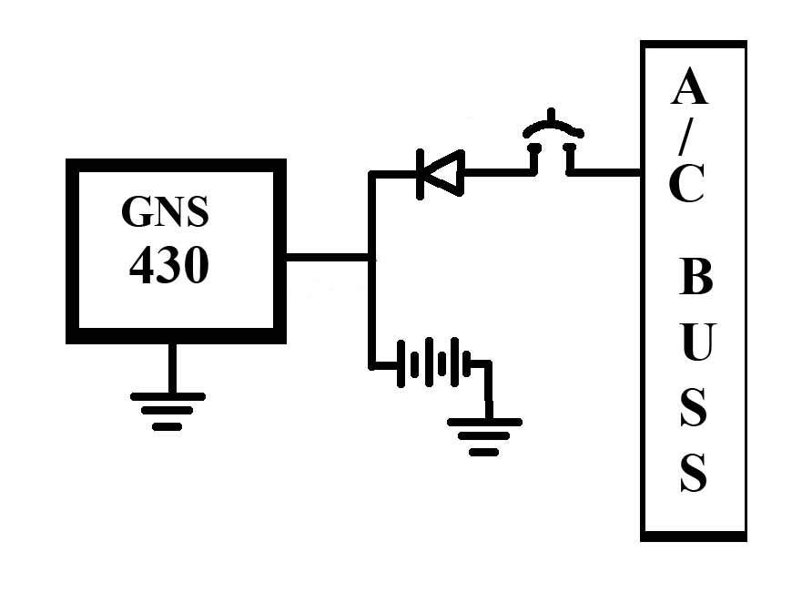

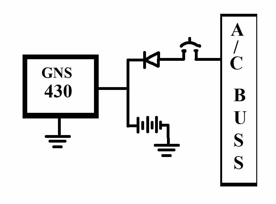

PostPosted: Mon Oct 02, 2006 6:25 pm    Post subject: Backup Power supply for GNS-430? Reply with quote
Item 6.
Even better you could put a forward diode in the positive line to your GNS and then wire the second (stay alive) battery in parallel to the first that way if voltage from the main battery dropped below 12V. on start-up the second battery would keep the voltage up to the GNS 430 during starting.
I'll attach a little thumb nail drawing. BTW this set up will keep the stay alive 12v battery charged while in normal operation. Both batteries would absorb forward spikes. I would suggest a small 12V gel pac cell or a battery pack of 9 or ten NiMh AAA batteries in series.
There is a very slight voltage drop across the diode but not enough for the GNS 430 to notice it. just choose a diode to handle the current of the GNS. You'll be surprised how small these diodes are. For safety put a piece of heat shrink over the diode and its leads
Noel [quote]
