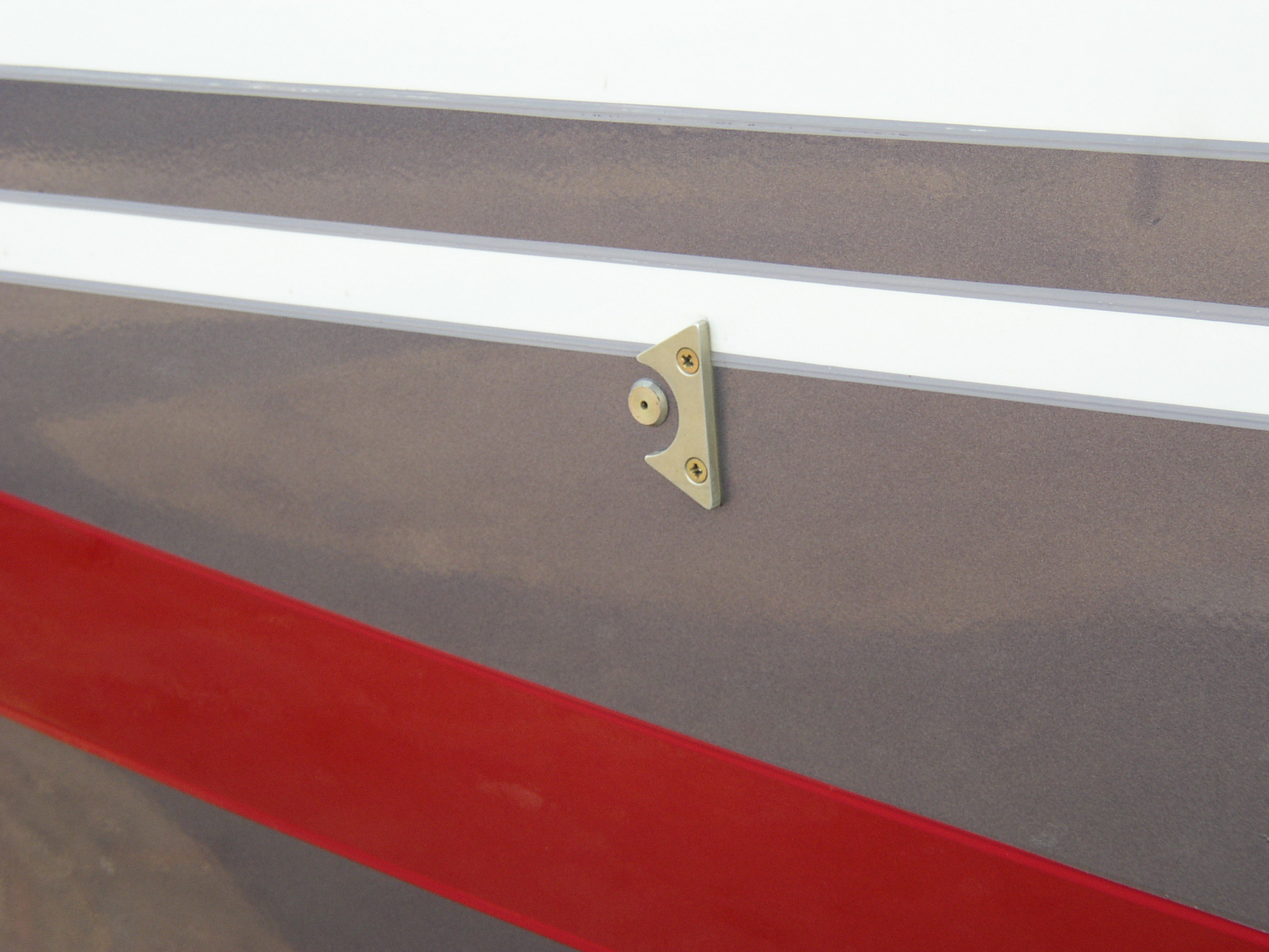

Here is a shot of the solution Dr. Carl Cadwell used on his Lancair IVP.
Sorry to the string and can folks. That was before he started such a
stir with his Epic LT which has led to the 51% Rule rewrite.
These static ports are critical in their exact location and design for
accurate pressure indication. Horseshoes and hand grenades are not
going to do it. You should see what is necessary for RSVM mapping.
John Cox
Do not Archive

That's not all that unusual, it seems a bit extreme but it does allow the air to breakup over the actual port. If I recall the oply problems folks have had with the Cleaveland ports (I'm using those) is making them flush with the skin. I think Mike piped in about the face of the port needs to be a thousandth or so above the actual aircraft skin otherwise the hole will act like a venturi and create a negative static pressure as the airflow passes over the static port.
Rick S.

Posted: Wed Sep 06, 2006 1:03 pm Post subject: Static port question |
No kidding. I'm in Cali for a few days with the Air Force Reserve, and we had to plow out here at FL280 because, even though our RVSM modification has been done, the FAA is taking it's time with the paperwork! And plowing along at that altitude meant we had to make a fuel stop because we can't take off from our home base with a full load . . .
TDT
40025
From: owner-rv10-list-server(at)matronics.com on behalf of Tim Olson
Sent: Wed 9/6/2006 2:17 PM
Subject: Re: Static port question
Wow, that's the first time I've ever seen such a thing as that.
Very interesting. Maybe tonight or tomorrow I'll stick something
thick on the plane in front of the port like that just to see
what happens. I've never used a hand grenade, but M-80's and
firecrackers can be fun.
Tim Olson - RV-10 N104CD - Flying 138 hrs
John W. Cox wrote:
| Quote: | Here is a shot of the solution Dr. Carl Cadwell used on his Lancair IVP.
John Cox
Do not Archive
