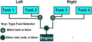

This is my first email on the Zenith-list. I am building a 701 from a kit I bought from the original purchaser. This kit came with four 10-gallon wing tanks but without a main tank. Since the only plane I ever built had a single tank, I could use some advice regarding the fuel flow configuration.
My initial idea (please advise) is to connect the 4 tanks to the Rotax 912S as shown in the attachment. I plan to use heavy 1/4 fuel line and don't plan to add a return flow line unless you feel it is needed. I also plan to put an auxiliary 4-PSI Facet electric fuel pump in-line between the engine and the right-left fuel selector switch. All the tanks will have fuel level gauges. The two wing tank selectors would be located on either side of the cockpit near the wing roots and the right-left selector would be on the instrument panel.
I know that with this config I have to keep tabs on three selector positions and the fuel levels in at least two tanks. Controlling flow in this manner seems logical since I will normally fly using only the inboard tanks and want to keep the outboard tanks dry (unless I am on long flights). I suspect that its best to fly with fuel flowing from tanks on both side at the same time to keep fuel levels the same in both wings.. but I could use advice about this.
Does this configuration work? Your comments would be helpful.

Les, if your Canadian then your fuel lines must be 3/8’s in size.

Les,
I purchased a complete kit with auxiliary wing tanks. The plans I have (7-6412, with section on Auxiliary Tanks) indicate the outside tanks(auxiliary) are connected using a "T", the inside tanks (main) are connected by a "T", and there is a switch to pick main, auxiliary, or none. I likewise have 4 fuel level indicators. Do you have top-mounted fuel level senders on your auxiliary tanks? I would be interested in hearing how you managed to get the sending unit to clear the top-skin. Likewise I would be interested in seeing responses to the need for electric fuel pump....
At times having just one switch seems to be a sufficient challenge while flying (1971 Piper Cherokee 140) with just left and right tanks. Having the added complexity of 3 switches - all needing to be in proper position - might be a bit much (IMHO).
Hope it helps,
Sam Hutcheson

Why don't you look at how I did mine? http://www.skyhawg.com/fuelsystem.html. It is straight forward and simple. I don't like a fuel selector switch. There has been lots and lots of accidents because of selector switches where the pilot thought he/she was switching tanks when in fact it was accidentally moved to the off position. I don't think the switch itself should have an off position. Turning off the fuel should be a separate deliberate function. If one insist on a selector switch with an off position, then make sure it is visible. My setup may not be totally idiot proof, but close.
On another note, wondering why I haven't flown yet? Well first I passed my airworthiness inspection with flying colors a couple weeks ago. Not a single discrepancy. Then I started to taxiing around on my field. One of the plastic fuel tanks started to leak, then another. I am now building four new fiberglass tanks, will be done today. The black cloud continued. Last week we started to program the EFIS (Dynon D10). It didn't function right, so it should be at the factory today for repairs. I am down for at least another two weeks. Other than that the test pilot was really impressed with the ground handling. The acceleration is great, front wheel was off the ground in 20' or less. I wouldn't let him take it up because I don't have insurance, and now it appears I can't get any. So when I get everything fixed, it's up up and away insurance or not. As soon as it flies, I will post the numbers on my site.

Posted: Mon Aug 28, 2006 1:33 pm Post subject: 4-tank fuel flow configuration question |
Here is a link to some pics of the 701 2 tank sender access. Simple cork sheet cut into rings(3 each) used to keep the skin or access cover off the top of the tank. Used contact cement to glue them together and to tank. One was glued to the doubler with nutplates. If skin is ever de-riveted there is no glue between the tank and doubler cork. The sender top can never reach the access cover using these.
http://share.shutterfly.com/action/welcome?sid=8CZsWbRuxZMNm¬ag=1
I have 4 lines comming down from the 4 tanks to behind the pilot seat. 2 gascolaters(Zenith box type) are mounted on a doubler plate on either side of the flap control arm. The one mounted on the left is for the inboard left and right tanks, the one on the right is for the outboard left and right tanks. There is drain to check for water at each of these. It is 1/4 fuel hose from each tank. Just before the gascolater is a small clear plastic brass filter from wicks for each tank. The output from the gascolaters (now 2 lines) are 5/16 fuel hose to a selector on the left side floor in front of the seat. Labeled off- inboard- outboard. 5/16 line exits this selector and continues up the left side to a flow sensor behind the rudders, exits the right side of firewall to an ACS gascolater. 5/16 fuel line covered in heatshield out of the gascolater to the
912 fuel pump input which is a 5/16 fitting. Output of fuel pump is back to 1/4 inch line, this goes to a brass hose T and then on to each carb. This is a stock setup except for the 5/16 line from the gascolaters on and per advice of Jim Greenough in Portland Oregon, the use
of AN842 brass right angle fittings with 1/8 NPT from Spruce to fit the gascolaters behind the seat for the 1/4 inch line from the tanks. It wouldn't work with the the straight hose nipples provided by zenith, you could not fit both gascolaters behind the seat.
Hope this helps
