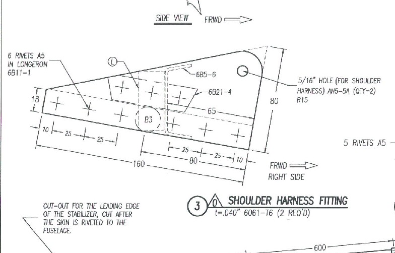

As usual you bring up a very good point. I talked to
Jon Croke at Oshkosh and saw his scars. Thanks for
the post. I'm attaching a portion of a scan from my
601XL drawings showing the 601XL seat belt attachment.
Here is a picture of mine installed since I followed
the drawings while building.
http://www.cooknwithgas.com/3_02_06_ELT.jpg
As you can see in the photo it is not used and I
attached mine further back using AN3 bolts into a 3/4"
thick longeron.
I did this for peace of mind. Thanks again,
Scott Laughlin
working on Engine Cowl

I discussed Jon's seat belt bracket issues with the
CAN-ZAC boys at Oshkosh. They have looked at Jon's
plane and specifically looked at the seat belt issue.
They told me that the top shoulder belt attachment is
designed to allow some give (crumple zone). On Jon's
plane this function served well. They did suggest
beefing up the attachment point a bit on the tunnel
since this is what let go on Jon's plane.
I'm thinking an 040 doubler on the inside of the
tunnel might be the answer. I'm not to that point and
will be discussing further with CAN-ZAC when I start
to get close.
Doug MacDonald
CH-701 Scratch Builder
NW ONtario, Canada

cffd(at)pgrb.com Guest
Posted: Sun Aug 06, 2006 8:54 am Post subject: 701 seat belt attach |
Doug,
Here is what I wrote.
When I built my 701, I did not feel comfortable with the aluminum seat belt
attachment that was riveted to the tunnel. In fact, somewhere 4 or 5 years
ago, on this forum, I read where the bolt between the seat belt and the
aluminum attachment pulled a slot through the attachment. So I made my
attachment from 0.40" 4130 steel instead of 0.40" 6061 aluminum. I then
used the 0.40" 6061 as a doubler on the inside of the tunnel to give more
thickness to keep the rivets from pulling through. I did not ask ZAC about
this, but I feel that this is a stronger anchor which actually gets pulled
by both the lap and shoulder straps.
Chuck D.
N701TX

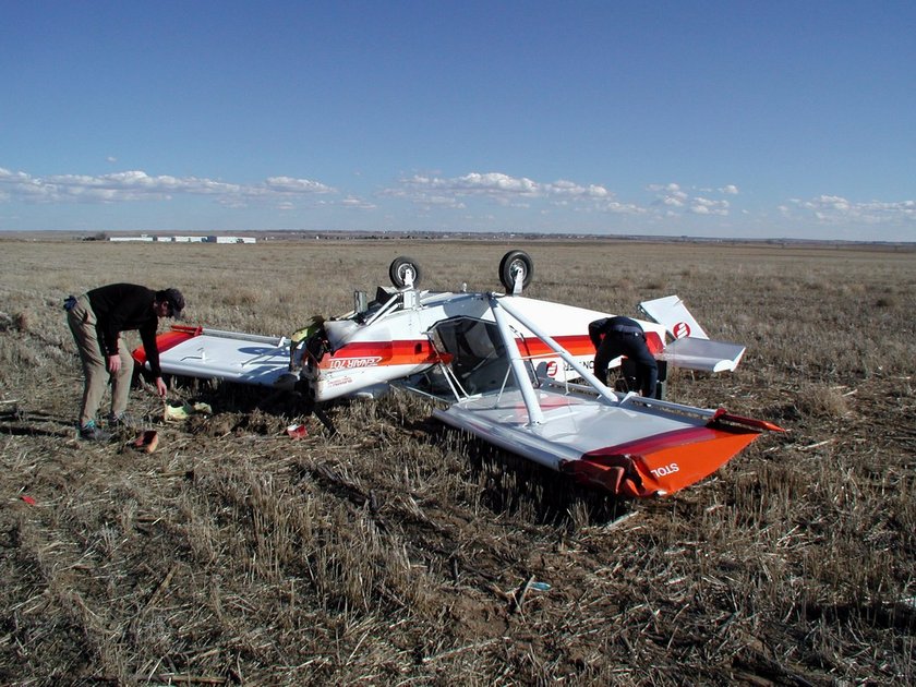

Here is a picture of the 701 plane crash that Chuck D. refers to........N4386W
And a picture of the seat belt attachment showing it pulled through.
It was not Chuck's or my plane. I believe the plane was in Colorado at the
time
Monty Graves

mgraves(at)usmo.com Guest
Posted: Mon Aug 07, 2006 8:11 am Post subject: 701 seat belt attach |
I forget what happened. Its in the archives
Looks more like he tried to land going across the rows instead of with
them. Looks like the nose wheel completely separated from the
aircraft. Then the nose and prop dug in and flipped....... Not sure what
kind of stubble that is, but a sure way to do some serious damage is land
in corn stubble across the rows.......
The plane was painted in Frontier Airline colors. I believe the pilot was
a pilot for them with high time hrs... just not in the 701........
Monty

In a message dated 8/7/2006 5:20:27 AM Central Daylight Time, mgraves(at)usmo.com writes:
| Quote: | Here is a picture of the 701 plane crash that Chuck D. refers to........N4386W
time |
It seems to be an early design, the belt attachment fitting thickness on early prints is .040.
Current prints call for .063 thickness. Just for info.

| Quote: | Looks more like he tried to land going across the rows instead of with
them. Looks like the nose wheel completely separated from the aircraft.
Then the nose and prop dug in and flipped....... Not sure what kind of
stubble that is, but a sure way to do some serious damage is land in
Monty
Thats wheat stubble in the picture, wheat stubble rows are fairly shallow,
but you can't rule out ruts from combine and grain cart tires.
R. Johnson

The 200 pound Subaru probably did not help the nose gear and the ability to
flare.

I am no expert in accidents but have made a couple of search and rescue missions and have talked to local experts a lot. This gives me some hints where to look.
I think this pilot got "get-down-itis" and just pointed to nose to the ground. Maybe he tried or thinked to level for flare when the front wheel was about an inch from the ground.
Look at the wing tips they just smashed to the ground, not a low speed stall, because both wing tips are damaged very similar, The plane was flown to the ground, also the distance where front wheel and the prop hub touched the ground is only a few inches from the nose of the inverted plane.
Good thing that was the old and lighter 701 and (I think) was not going fast (40 mph or less maybe), but he just hit the ground at an angle (?)!. He was lucky to survive (he is commenting the accident, another hint ...
Just my point of view, probably completly wrong. Please Do not archive.
