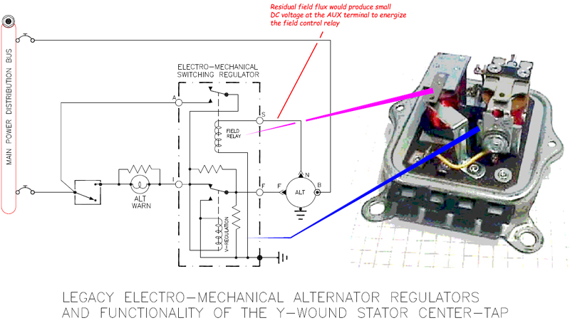

You're correct but with a couple of factors unique
to our applications:
I looked at the ancestors for this device while
still at Electro-Mech, circa 1980. The functional
'stumbling' block was feature called 'phase sample'.

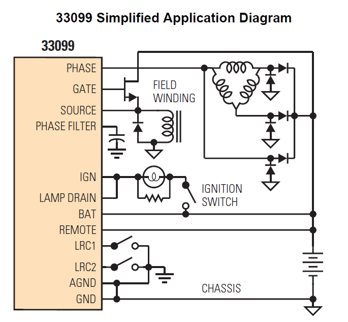

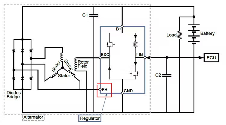

The chip needs manage field excitation and shut
it down if the alternator is not rotating.
When the vehicle has systematic control over
field excitation (like an alternator field switch),
field current is shut off externally. In a one-wire
alternator, some internal means for field excitation
management is needed. The two diagrams I've attached
show the connector to one phase of the stator winding
where presence of an AC voltage annunciates alternator
rotation.
Early alternators utilized the
AUX terminal driving the "S" terminal (field
excitation relay) in the alternator to effect
field control.
