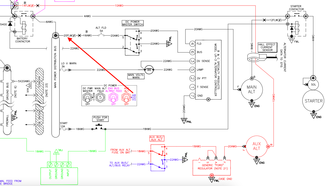

1) Clarify for me why the Z101 Alternator Field portion of the Master Switch circuit that runs from the Main Bus Bolt to the Master Switch circuit calls for a fusible link between the bus bolt and the 5A CB.
2) Clarify for me how the Aux Feed (Brown Out) bus is used. Is its normal use limited to pre flight activities? Is it normally off or on during flight? Are items on the bus like the #1 COMM radio powered normally from the Main Bus with the AUX Bus power use temporary during start and clearance delivery activities?

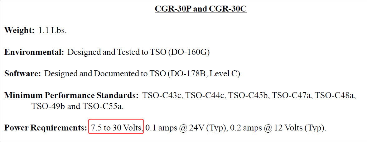

3) Does your Electronics International CGR-30P Engine Monitor stay on line during engine start, or will it reboot?
The wire from the bolt (probably located next to the battery, either on the firewall or in the aft cabin area) to the ALT FLD circuit breaker (on the instrument panel) would otherwise be unprotected against a short to ground. Since fuses and CBs are not used in series, the fusible link wire provides protection against a dead short while easily carrying normal field current and being essentially immune to nuisance trips or vibration effects.
The AUX BUS/AUX ALT switch is normally off during flight, and the AUX BUS is fed via the diode bridge (colored pink, labeled "W10," just above and to the right of the battery contactor). If the BATTERY CONTACTOR fails open, that feed is lost, so the AUX BUS/AUX ALT switch is moved to the center "AUX BUS" position, closing the AUX BUS ALTERNATE FEED relay and feeding the AUS BUS from the fat wire tie point on the hot side of the BATTERY CONTACTOR. If the main alternator or regulator fails, (as Bob would say, finish your cup of coffee, fold your newspaper, then...) move the switch to the upper position to close the AUX BUS alternate feed relay and activate the auxiliary alternator.
The AUX BUS switch can be closed to activate the relay during preflight activities if needed, then once the MASTER switch is on, turn the AUX BUS switch off.
The AUX BUS will not inherently prevent any susceptible avionics from rebooting during engine start. That protection must be built in (low minimum input voltage) or be added via an inline energy storage device (backup battery or capacitor bank) or via a DC-to-DC boost converter (as shown in green, below the MAIN POWER DISTRIBUTION BUS).
If the airplane is intended for IFR flight then you'll probably opt for a backup battery to maintain instrumentation under all circumstances. All other options that we've considered on the AE-List work only as start-induced-brownout protection.
It will probably be fine. According to the specifications shown here...
https://iflyei.com/product/cgr-30p-premium/#CGR-30P-Specifications
...the power requirements are 7.5-30V. Something is wrong if your bus voltage is dropping below 7.5V during start.
Brooks Cone
Bearhawk Patrol Kit Build
For #1, it's to protect the wire between the bus and the breaker. The
bus has enough current available to 'light up' the wire; because it's
tied directly to the bus, protection is needed.

1) The CB is usually part of the crowbar over voltage protection for the alternator. If it is fed by a long wire, it can be shorted without tripping the downstream CB. we usually find it appropriate to protect the plane from burning with a fuse or fusible link. Makes me wonder if the CB should be closer to the battery...
2) Brownout preventer keeps the volatile memory alive through engine start. Cranking usually draws circuits to 10 Volts or below, which usually causes electronics to reboot. These gadgets keep the navigator alive through cranking so you can program routes, etc before engine start. Evaluate the need based upon your use, programming, etc.
By design, the alt field breaker needs to be pilot-accessible while in
flight, in consideration of a potential 'nuisance trip' (reset *one*
time if it trips in flight). Having it closer to the battery would mean
having the battery close to the instrument panel....

1) I understand now why we fuselink the ALT FLD wire at the main bus. Thank you for helping me understand.
2) I understand now why the B.O. Bus exists, and how it is powered, and how it is to be used during the preflight, under normal circumstances, and after a Main Alternator fails. I also now understand how the Brown Out preventer helps keep voltage up during engine start. Thanks again for helping me.
3) I learned from another user that this engine monitor I have chosen stays on line during engine starts without a brown out preventer circuit.
The installation manual says it works between 7.5 and 30V.
Awesome, Thanks for hunting that down John! Feedback I'm getting fro a supercub owner agrees that it stays on line during start.
