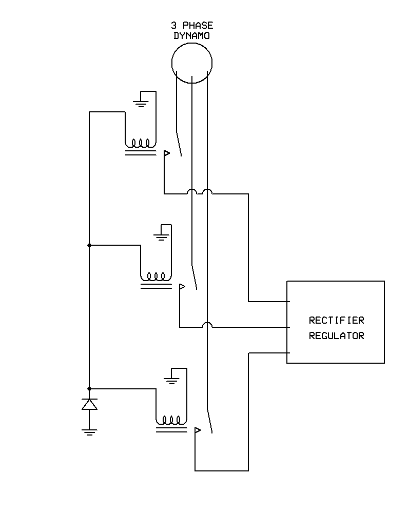

Below is a drawing showing 3 relays that can shut off the charging system right at the source.
Substitute the 3 relays for the single relay shown in Z-16. Only one flyback diode is needed for all 3 relays.
You only need two relays to completely shut down
the 3-phase supply.

You only need two relays to completely shut down the 3-phase supply.
Thinking out loud here... If the OVP sensor trips, then isn't it safe to assume that the regulator has already failed? If so, then why would we be concerned about damaging it by disconnecting it from the battery? Is there some other reason not to use a single relay to disconnect the regulator's output from the bus rather than multiple relays to disconnect the alternator's phases from the regulator?

I am aware of at least two people that wired it as you described, Eric. I guess a downside (if I am understanding correctly) of this arrangement would be that you wouldn't want to manually disconnect the alternator via the switch for fear of harming the regulator, but I can't see why you would want to do that anyway unless there was a problem. With two relays wired prior to the regulator, you would be able to shut it down manually without harming the regulator, correct?
Also, the B&C OV kit is only rated for 30 amps. I found these that are rated for 60 A. Would this work? I'm assuming they can be mounted FWF.

I thought about using just 2 relays. But what if the dynamo windings are
connected in "Y" with the center grounded? Or is that highly unlikely?
Could be, but Not necessarily. Depending on the the aircraft wiring, there could be resistance causing a voltage drop that
the regulator interprets as low system voltage. Thus the regulator would increase output voltage and cause an overvoltage event.
That problem can be minimized by not putting a load on the voltage sense wire. But it has happened.
It sure sounds that way.
Yep, those would work. That sort of relay is mounted in vehicle engine bays all the time. The datasheet says they're rated up to 125°C (257°F). Be sure to order them with a mounting tab on the back.
More thinking out loud... I'll bet that a 30A relay would be more than sufficient since the alternator's 50A max output would be evenly split across the three phase wires (~17A per wire). Bob, am I out to lunch here?

I think I'll go with the two relays wired before the R/R, so I can have manual control of shutting off the alternator. If I could use the 30 A relays from the B&C kit, that would be even better. I'd like to hear Bob's thoughts, too, on using the B&C relays.
One more question...how would I wire TWO relays with the B&C overvoltage sensor. I have looked everywhere I can think and I can't see that documented anywhere.

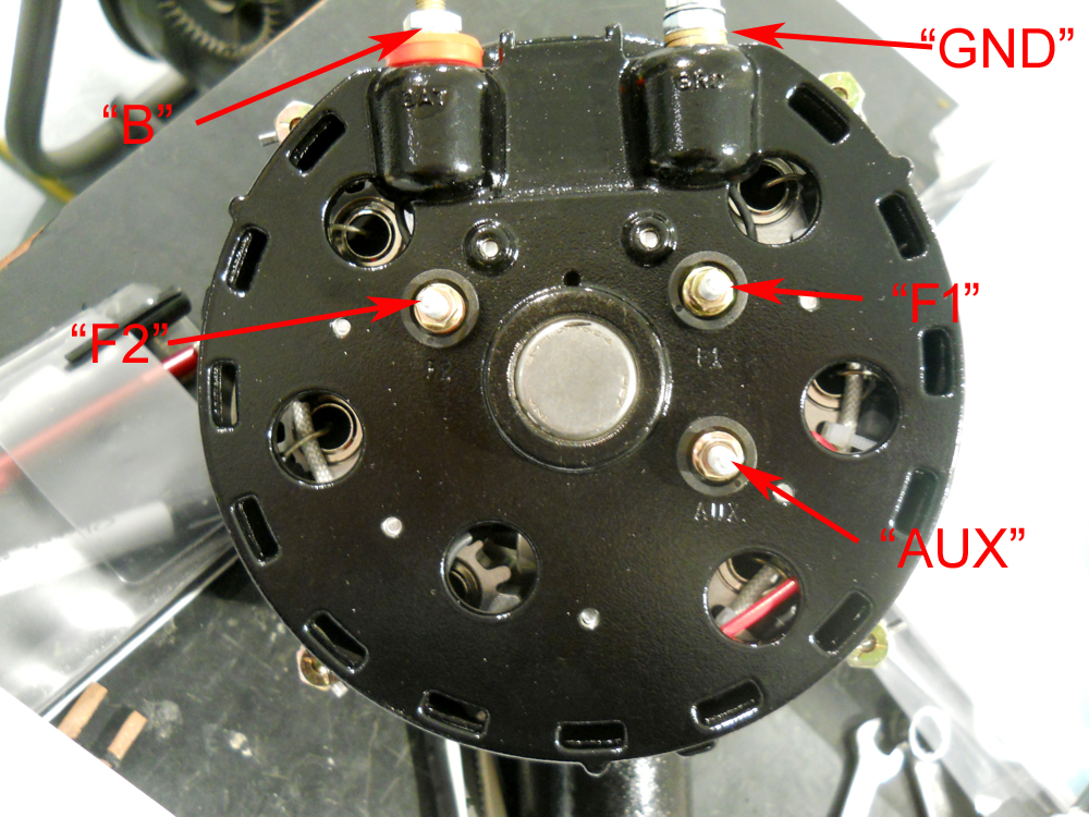

There are some legacy products being offered as
spares which are y-wound, but I'm not aware of
any modern y-wound devices. In any case, y-wound never
grounds the center. Some designs bring that
node out as a AUX terminal . . . this is the connection
that used to drive the "S" terminal on the legacy
electro-mechanical regulators.
Current production B36 and B55 alternators at
Beech still have an AUX terminal but it hasn't
be used in decades.
30A relays are plenty big . . . especially
given the fact that they're switching AC
current.

See attached
out of that stuff?"
3-Phase_PM_Alternator_Control_and_OV_Management.pdf
