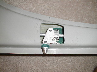

I am completing 272 which was started by Tony Krzyzewski here in New Zealand. One of his early modifications means that this aircraft has THREE bolts securing each door - there is one in the middle - Also the hydraulic lifter was repositioned from original (I now think this is standard) and he spent a lot of time making the doors fit well, so the doors close properly each time, every time and do not bulge out that I understand was a problem from the native design.
I am three years into completing this aircraft with a year to go and it has not been out in the sunshine yet, so I am not sure if the door will bulge and make it fit differently when hot. But considering the aircraft is experimental, should not each builder decide if a change should be made and how it should be done, with your UK LAA just suggesting a possible fix ?
New Zealand tends to "follow suit" with CAA/FAA directives, but I am not sure about the LAA in this case.
I was considering a mod for the future, where I could optionally take a door off and replace with a specially made half-door for sunny day flying (at lower speed) this would be quite nice I think and of course this would be an experimental door - is this not the whole point of experimental aircraft, Innovation through careful experimenting ?
Trevor

Fwiw. My bird has those third bolts, but alas, the rear bolts still can miss the sill.
But my precheck and idiot light is good enough for me. (did i say that put loud? Lol)
Knock on wood.
Pete

Correction, checked again, and indeed my center pin does pull the door in enough to cause the rear pin to interfere against the stock door rebate in the worst case. So i guess the center pin does indeed have the same effect as the new uglymod. Smile
Cheers,
Pete

In NZ, we can keep the aircraft experimental, provided we are "experimenting" and making changes. From memory, this requires some more paperwork and restrictions. What normally happens, is after a period, it is moved into the Amateur Built category and the builder can do maintenance provided they to a CAA course of a few days, that focuses on paperwork - I have not decided exactly how I am going to proceed because I may choses later to experiment with auxiliary electric wing pods - ha.
We do however have some creeping legislation here, the ADSB has to be signed off by an Avionics LAME even on a homebuilt because it is part of a countrywide certified system, so this has added some complication.
Back to the shoot bolt - good to hear from peterz that his third bolt works also. I cannot see how this door shape fault is any more dangerous than leaving the wing pins out which is a checklist item of course. I am a checklist person and rigorously pick up my checklist and read through, talking to myself even now after flying 20 odd years flying, so I a not going to take off unless I have completed the checklist, the checklist is PART of the takeoff in my mind PERIOD.
I am sure once I get the Europa flying, I will be probably more pedantic - I have already started writing the checklist that is specific to my aircraft, for example, checking that the panel heat extractor fan is running by placing my hand over the vent to feel the air and checking I can see the fuel level using the reversing camera that points to the sight gauge positioned BEHIND the pilot and so on ..
Thank you for the feedback guys
