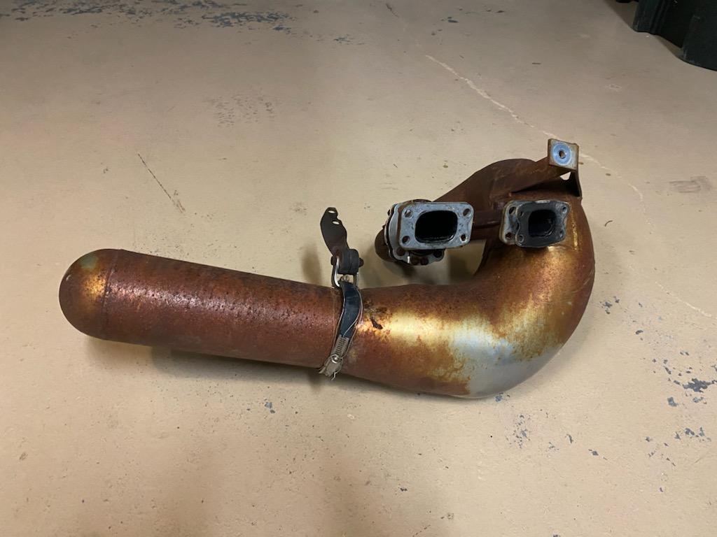

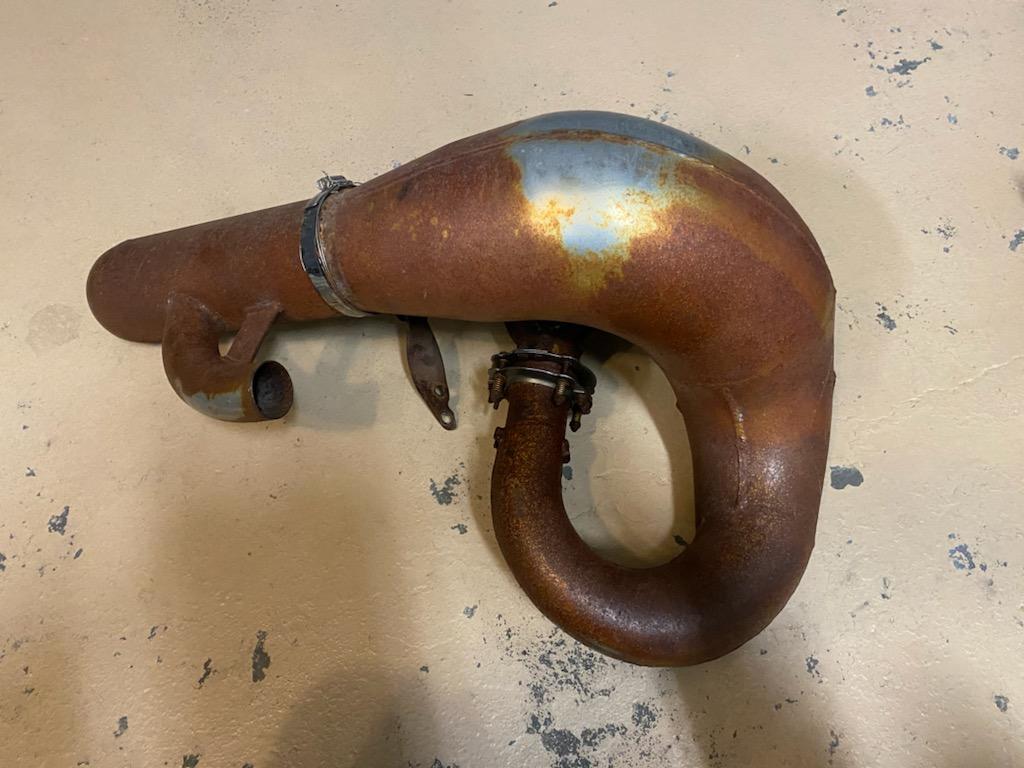

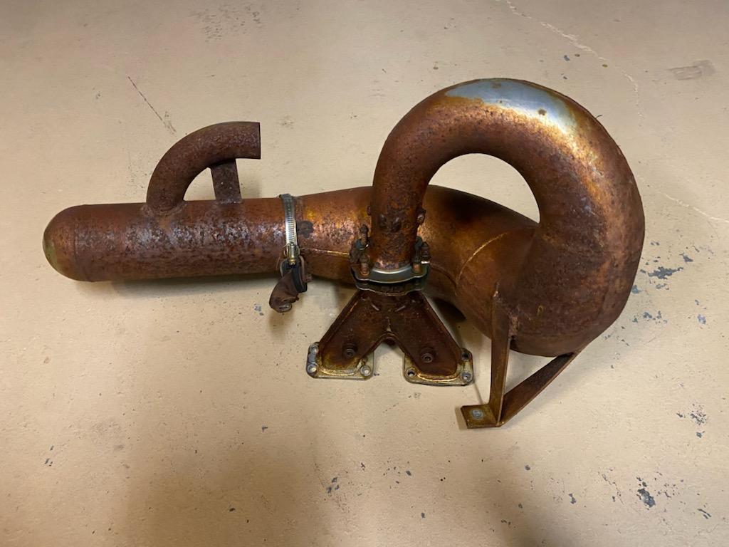

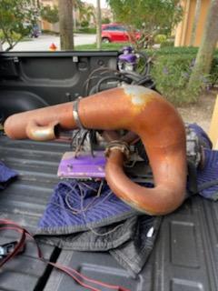

PostPosted: Fri Jul 30, 2021 9:24 pm    Post subject: Re: Rotax 582 high mount exhaust Reply with quote
I have this if interested! Thanks, Chic
