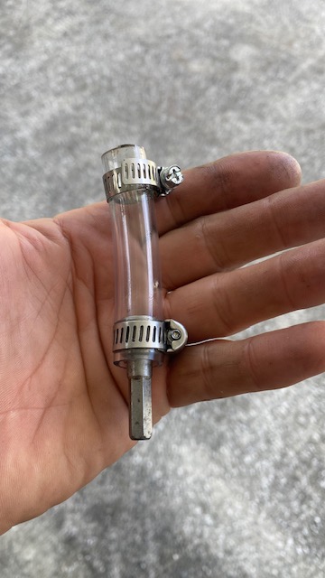

Lenny Iszak
Joined: 23 Mar 2008
Posts: 270
PostPosted: Wed Aug 26, 2020 10:08 am    Post subject: Exhaust valve leaking Reply with quote
1/2” ID.
This setup works well, see attached photo.
Lenny

Lenny Iszak
Palm City, FL
2014 RV-10, N311LZ - 500 hrs
