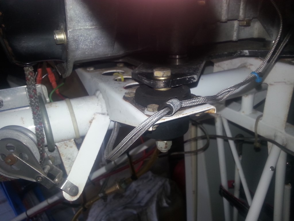

| loctupdave wrote: | does anyone know what purpose this tab serves. I plan to cover this into a full canopy and it will be in the way. My thought is to cut it off.
distant pic
It would seem to be the attach point for the pulley for the pull start.
See attached photo.
